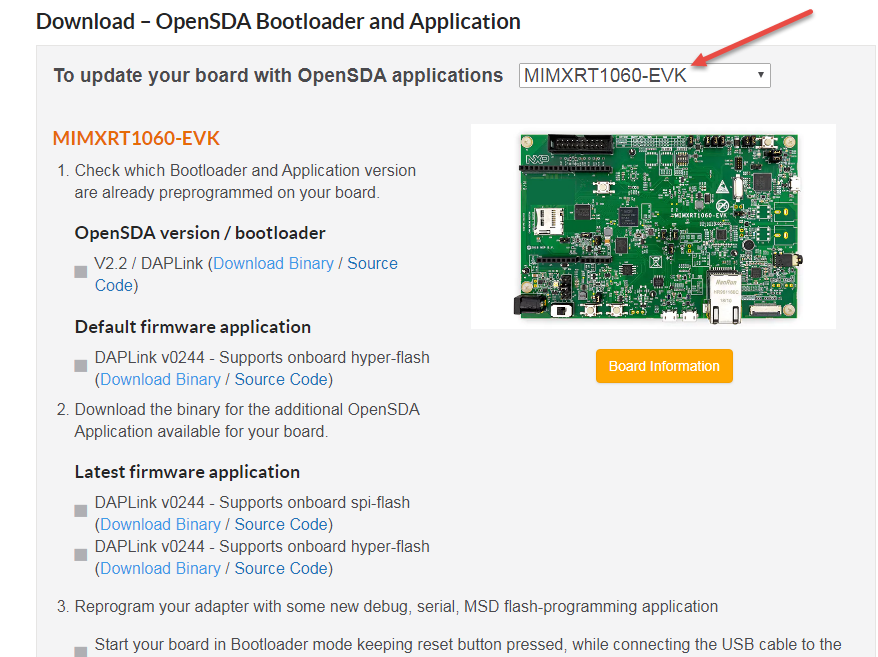

After connected with PC, there is nothing happened in my PC, no unrecognized device and no COM port.  I am not sure it is a hardware issue or software issue. Shall we need to update DAP firmware like 1050 in following page? I still not find the document for RT106A.

jeremyzhou
Hi xinui sun,
Thanks for your reply.
It allows you to select the MIMXRT1060 board actually, then you can download the firmware for the board.
