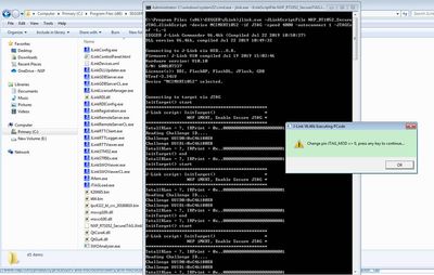

vanessa_dis
Hello
I'm using an IMXRT1050-EVKB REV A1, and the micro said MIMXRT1052.
I did the fuse configurations described here https://www.nxp.com/docs/en/application-note/AN12419.pdf.
and I've read that J32 and J33 should be removed, so I removed those jumpers.
And when I tried to debug in MCUExpresso (without run script in j-link) it let me debug like this image.
(i'm using JTAG connector on J34)
I don't know if it would be like this, i mean, if this is correct.
And if I try to run the script, it didn't identify UUID0 and UUIDD1, it doesn't matter if I put JTAG_MOD in 0 or 1, it never find UUID's
I'm not sure what steps I have to follow then, because I just blown the fuses in the manual.
I hope you can help me,

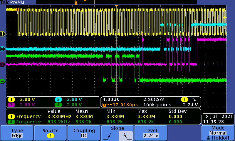

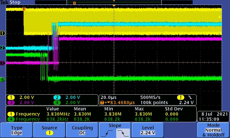

  Check my oscilloscope wave:
ch1: TCK
Ch2: TDI
ch3: TDO
ch4: TMS
You can seem, my board have the wave.
So, if your board even no wave, I think your JLINK even didn't really connect to your RT board with the JTAG interface, you need to check your connections.
It's better use the 20 pin JTAG cable directly instead of your wire by wire, if you can't make sure your connection is correct or not.
Wish it helps you!
If you still have questions about it, please kindly let me know.

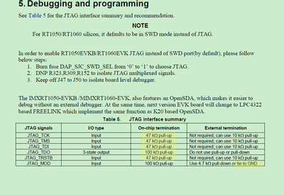

Hi @vanessa_dis ,

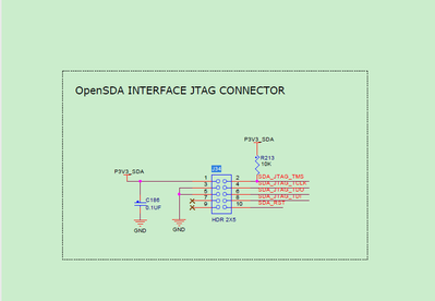

   Please double check quickly, which JTAG interface you are using?
   From your picture, seems you connect to J34?
   Please note, J34 is not the RT1050 chip JTAG, it is your on board K20(debugger ) JTAG,
You need to use J21 as the RT JTAG:
This is the key point, please also check your JLINK commander, you can find you find the ARM cortex M4 core, it is the K20, RT is ARM cortex M7 core.
Any updated information from your side, please let me know.

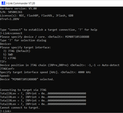

vanessa_dis
Thanks for your help Kerry.
That explain a lot.

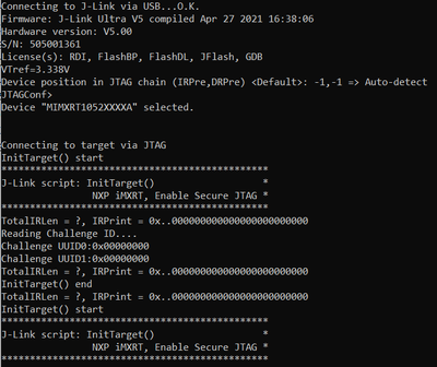

Yes, you're right, I tried with J21 and now it detects the target. Although, it appears like this. With this error:
TotalIRLen = ?, IRPrint = 0x..000000000000000000000000
If I try doing key validation, and put JTAG_MOD=1, it's the same
Thanks a lot Kerry,
Vanessa
4,024 Views
kerryzhou
Hi @vanessa_dis
Do you totally follow the chapter 4 Debugging with the Secure JTAG enabled steps on your side?
In my memory, I test it with the validation board, it works OK.
Do you already manually control the JTAG_MOD like the AN12419 mentioned?
The following are my test result, seems your Lock side still have issues, just share my pictures at first from my previous testing(about two years ago):
Please check your situation with my previous testing result.
kerry
4,016 Views

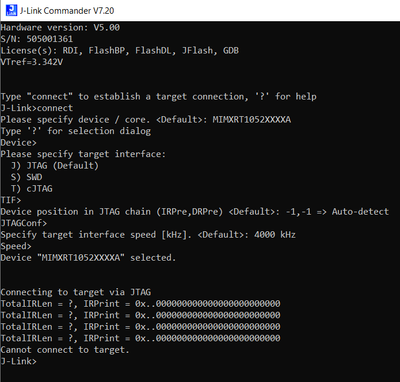

vanessa_dis
Thanks for your answer Kerry,
Yes, exactly, I used to debug with SWD.
And Yes, I removed the resistor to JTAG_MOD ( I shouldn't have done that), but in SWD when I manually put JTAG_MOD to GND, it worked very well. Then I changed that to JTAG, and after the error I soldered again that resistor, I tried with that and also I have tried to put manually to GND (as SWD).
This is my log
About the others pins: TMS, TCK, TDO, TDI are directly connected to JLINK, and TRSTB is connected with a resistor to Vcc
Thanks and regards,
Vanessa
3,925 Views

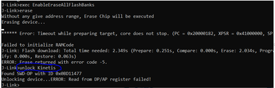

Just to correct me for my previous repply, this was the output when I tried to read and print the values of JTAG_MOD (with an image)
also I would like to say that before doing this modification I had experimented some errors when I tried to erase my flash via J-LINK,
and reading I found that I had to unlock kinetis but it didn't work
Do you think this is like a kind of reason that connect with JTAG doesn't work? (even thought, this is rare because with SWD worked perfectly with this problem) Or do you thing that this is other independent problem?

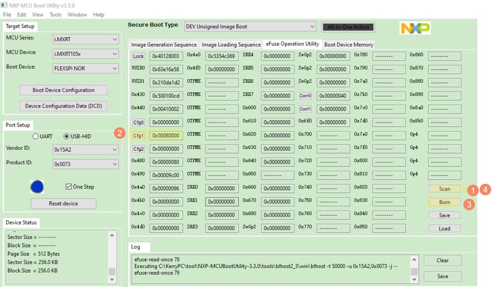

1. Enter serial download mode, use the MCUBootUtility to test the normal situation at first.
   I do these things, download a led_blinky code, and check it works.
   scan the fuse map, it is:
Totally no modification for the fuse.
2. exit the MCUbootUtility, board switch to the internal boot mode, use the JLINK SWD+JLINK commander to connect
OK, SWD works normally.
Key point coming!
3. Enter serial download mode, connect the MCUBootutility, modify the fuse 0X460[19] DAP_SJC_SWD_SEL from 0 to 1, it will be DAP works in JTAG mode
This is my fuse situation:
You can find my fuse modified, right?
4. Exit the MCUbootutility tool, enter internal boot mode+reset
Then use the Segger JLINK plus+jlink command+jtag to connect
You can find, my JTAG works OK.
Please note, don't worry about your JTAG_MOD pin, just connect to GND, I am the same as you.
If you still have issues, you need to check your other JTAG pins. Make sure it is not connected to other external module except the JLINK.
Please catch up with me, then we can write the key, enter the secure jtag mode.
I just want you to follow me step by step, as I am totally consuming one new chip to help you!
Kerrry

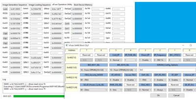

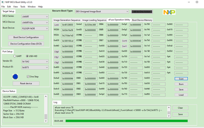

kerryzhou
I don't know why the community have the picture attach issues in the previous reply for the step 3, although attach successfully, but publish will be disappear, so I reply another post to add the picture:
3,827 Views
vanessa_dis

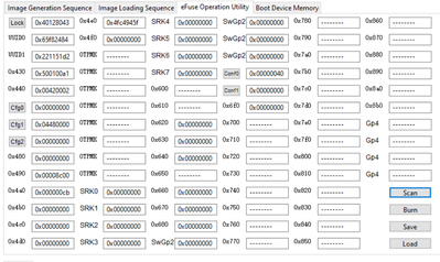

Yes, That's what I did, this is my fuse map if I read it:
Vanessa
3,820 Views
