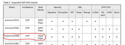

slimSHA
Thanks for the reply,
I found this from SBL user guide,
it says that the evkb1050 boot device is hyper flash, does the SBL project support SDCard boot?
1,505 Views
jeremyzhou
Thanks for your reply.
1) It says that the evkb1050 boot device is hyper flash, does the SBL project support SDCard boot?
-- Yes, however, It needs the developers to modify it.
