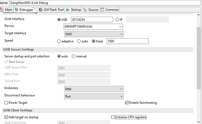

My jlink suddenly couldn't connect to my RT1064 board, and now the J-link commander only can get the RT1064 information but cannot debug in MCUXPresso.
My debug environment:
IDE
CUXPresso 10.3.1
Debuger
Jlink Base
Debuger Driver
Jlink V6.84 Driver

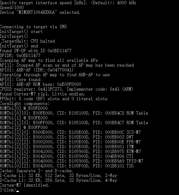

1. The J-Link Commander can get the RT1064 information

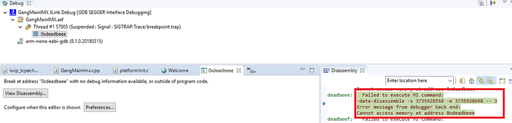

2. MUCXPresso shows following error
and the jlink display following log:

ERROR: Cannot read register 48 (FPS15) while CPU is running
ERROR: Cannot read register 49 (FPS16) while CPU is running
ERROR: Cannot read register 50 (FPS17) while CPU is running
ERROR: Cannot read register 51 (FPS18) while CPU is running
ERROR: Cannot read register 52 (FPS19) while CPU is running
ERROR: Cannot read register 53 (FPS20) while CPU i
3. My jlink configuration
jlink-configure2.pngjlink-configure2.png.
Anybody has ever get this issue and give me some helps? thanks.
