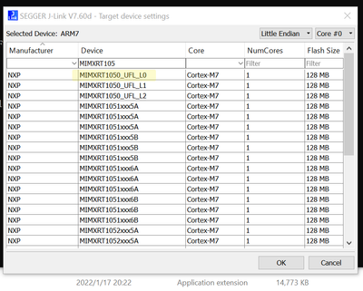

    In the previous time, I mean the old JLINK driver, eg, JLink_V644i, it contains the NXP_iMXRT105x_QSPI.elf, but I find the new Segger JLINK driver already remove the NXP_iMXRT105x_QSPI.elf from folder:
So, if you want to use the JLINK with QSPI firmware for the RT1050, I suggest you use our AE designed RT-UFL, that is very easy to use.
More details, please refer to Jay Heng's blog:
https://github.com/JayHeng/RT-UFL/blob/master/README-en.md
Download it:
https://github.com/JayHeng/RT-UFL/archive/refs/tags/v1.0.zip
Then unzip it, copy the file in
   \RT-UFL-1.0\algo\SEGGER\JLink_Vxxx
 to:
C:\Program Files\SEGGER\JLink
 Then, when you select the device, select:
  MIMXRT1050_UFL_L0
Then it will helps you use the QSPI flash.
_L0 : QSPI Flash and Octal Flash(Page  size 256 Bytes,Sector size 4KB)
_L1/2 :  Hyper Flash(Page size512 Bytes,Sector size 4KB/64KB).
Wish it helps you!
