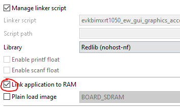

I'm trying to boot from the SD card on the board RT1050
According to the Application Note AN12107 tutorial, use the IAR toolchain to generate the flash file. Then  using MFG tool to program an image to SD Card and Boot from the SD Card.
But I'm not using IAR right now,
so, how can i program an image to SD Card without using IAR. Example by MCUXpresso

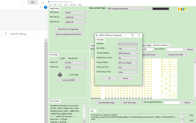

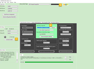

1. Download the MCUBootUtility tool, this tool is more good to use, i use this download the code to the SD card.
https://github.com/JayHeng/NXP-MCUBootUtility/releases/tag/v3.3.1
2. Use my attached evkbimxrt1050_ew_gui_graphics_accelerator.s19 file, I generated the code which is located in the SDRAM. Find it in the attached file:
evkbimxrt1050_ew_gui_graphics_accelerator\Debug
3. Use the MCUbootutility tool to download the code
 SW7:1-ON 2-OFF 3-OFF 4-ON. usb cable connect to J28 and J9.
dcd.bin path is:
NXP-MCUBootUtility-3.3.1\src\targets\MIMXRT1052\evkbmimxrt1050_xip_boot_header_dcd.bin
Then connect  to ROM,
APP file just select my attached .s19 file, click step 3 all-in-one-Action button download the code and wait the download finished.
Then exit the MCUbootutility tool: reset device.
Now, SW7:1-ON 2-OFF 3-ON 4-OFF. press reset button on the board or repower on the board, you will find your LCD is working.

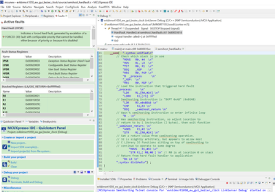

So, I run your code directly, debug it at first, just run it on my MIMXRT1050-EVKB board, when I run it, it can go to the main, but, when do full run, it enter the hardfault:
So, seems your original project has issues if download to the SDRAM directly.
That's why you copy it from SDCard to the SDRAM and run it, it has issues.

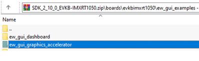

I used SDK_2.9.1_EVKB-IMXRT1050, so there's a project "ew_gui_bezier_clock" in it
I just downloaded SDK_2.10.0, and tried with project "ew_gui_graphics_accelerator", With QSPI boot, works fine.

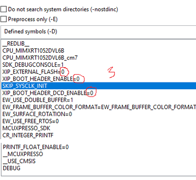

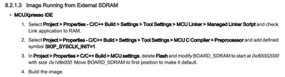

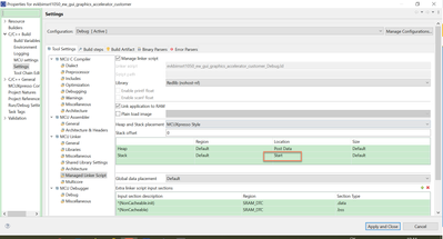

  1. In Tool Settings > MCU Linker > Managed Linker Script -> check Link application to RAM.
  2. Project > Properties - C/C++ Build > Settings > Tool Settings > MCU C Compiler > Preprocessor -> add defined symbol SKIP_SYSCLK_INIT=1.
  3. disable the XIP header XIP_BOOT_HEADER_ENABLE=0

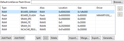

  4. In Project > Properties > C/C++ Build > MCU settings, modify BOARD_SDRAM to start at 0x80002000 with size 0x1dfe000. Move BOARD_SDRAM to first position to make it default
  5. Build the image
    make the file "evkbimxrt1050_ew_gui_smart_thermostat.axf"

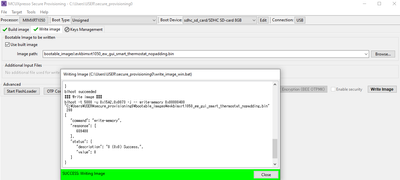

  6. Use the MCUxpresso Secure Provisioning
        6.1. Set EVK in serial Download mode (SW7 0010)
        6.2. Build image
    6.3. Write Image

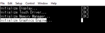

But the app does not seem to run, the screen does not respond, when viewing the log, it is stuck at "Initialize Graphics Engine"
 please correct my mistake
Can you check from the beginning, my goal is to know how to boot from SD card

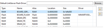

Refer to your project, I modified from the original project as follows:
1. Link application to RAM
2. in MCU setting
move SDRAM to 2nd position, edit location 0x80000000 to 0x80002000,
and Size from 0x1e00000 to 0x1dfe000
-> Can you explain to me why change to 0x1dfe000?

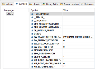

3. in C/C++ Build/Setting/ MCU C Compiler/Preprocessor
change XIP_EXTERNAL_FLASH=1 ->0
XIP_BOOT_HEADER_ENABLE=1->0
XIP_BOOT_HEADER_DCD_ENABLE=1->0
4. Build project, create .S19 file
5. Use MCUbootutility tool to download the code according to your instructions.
reset board. But It's not work
Did I miss something?, please help me

Hi @haryanl ,
  In fact, my project also share with you, you can check that project, I also modify the stack start address, just in the link to RAM page.
  You can compare your modification with my project.
KERRY

kerryzhou
Hi @haryanl
You didn't modify the stack start location, which I have told you in the previous reply with description:
After this modification, your project also works on my side.
Please check it again on your side.
Kerry
14,356 Views
haryanl
Hi @kerryzhou
I fixed it and my project is running
I was thinking to fix the memory stack
Finally, I really appreciate your enthusiasm

Hi Kerry
Following your instructions, I burned the code to the external SD card with MCUXPresso Secure Provisioning.
For iled_blinky app, I tried it successfully.
but when I try with "evkbimxrt1050_ew_gui_bezier_clock" app(app size 3.5MB), the clock doesn't run, Touch doesn't work either.
Is it lack of memory, I don't understand it well. Is there any way to fix this?
