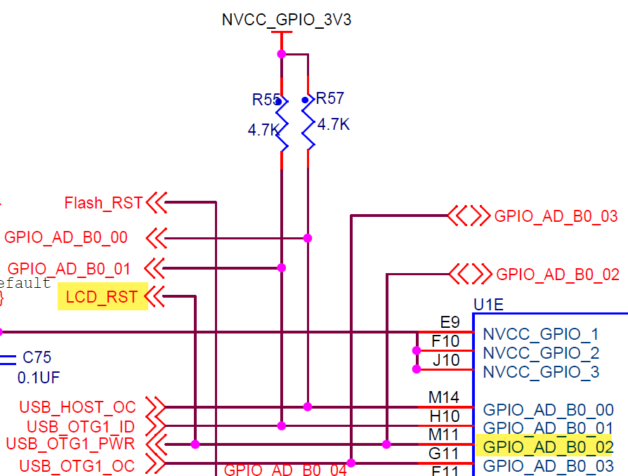

I'm looking at the RT1060 reference manual, and in "Table 35-5 - Pin use in DOTCLK mode", at the end of the table, an LCD_RESET signal is mentioned.  The string "LCD_RESET" does not appear anywhere else in the document.  It is not mentioned in the datasheet.  Google reveals an app note AN12302 "i.MX RT eLCDIF RGB Mode Use Case" which mentions the LCD_RESET signal but doesn't define where it appears.  The LCD_RESET signal also does not appear anywhere in the MCU Config Tools pin selector under the LCDIF column.
Does the LCD_RESET signal actually exist?  Or is this an artifact from an older revision of the reference manual?

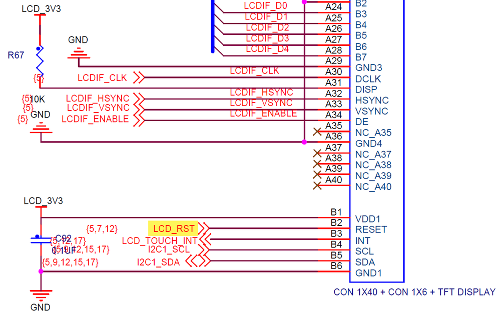

FelipeGarcia
Hi David.
As it is mentioned in the application note you referred to, LCD_RESET signal is configured as GPIO. Please check the snippets below from MIMXRT1060-EVK.
Hope it helps!
Felipe

dmarks_ls
Senior Contributor I
OK, so on the EVK, it's a manually controlled GPIO.  So why is an LCD_RESET signal listed in the RT1060 reference manual in Table 35-5 if there's no actual LCD_RESET signal present in or generated by the LCDIF peripheral?  In the MCT Pins Tool, there's no entry in the LCDIF column for GPIO_AD_B0_02.  It seems to me that "LCD_RESET" should be removed from the RT1060 reference manual Table 35-5 (and from RT1050 RM Table 34-5, and from RT1064 RM Table 35-5), because no such signal exists in the peripheral.  Please confirm my finding, thanks.
