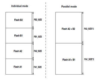

I have a new design and need clarification on how QSPI flash units are addressed.  I have two 128Mb flash chips running on the Flexspi unit of a iMXRT1062.  One is tied to SPI-A-SS0-B and the other is tied to SPI-A-SS1-B, the rest of the signals are shared.  Would I be able to access 0x60000000 to 0x60010000 with the second chip automatically selected at the rollover point?

1)Would I be able to access 0x60000000 to 0x60010000 with the second chip automatically selected at the rollover point?
-- No, I'm afraid not, and I'd like to suggest you go through the 27.5.5 Flash memory map section in the RM to learn the memory assignment.

2,930 次查看
kef2
Senior Contributor V
  • 1)Would I be able to access 0x60000000 to 0x60010000 with the second chip automatically selected at the rollover point?
Hm, my answer is yes, of course. Provided FAx_SIZE and FBx_SIZE settings are programmed correctly and do match memory chip sizes, QSPI memory area should be contiguous like it is shown in your picture, chip selects will act accordingly. Memory chips, which are not used may have their settings FAx_SIZE or FBx_SIZE equal zero and that would be still contiguous memory area.
