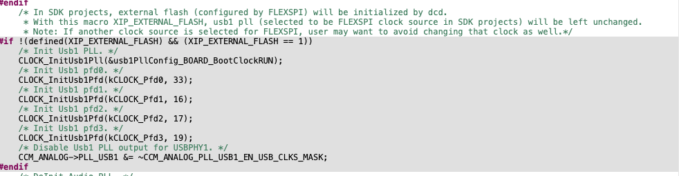

5. I noticed the Power Mode Switch Demo actually alters the USB related PLLs - I thought this was NOT recommended when running code from XIP? (as per here from clock_config.c):Screen Shot 2020-06-23 at 7.19.04 PM.png

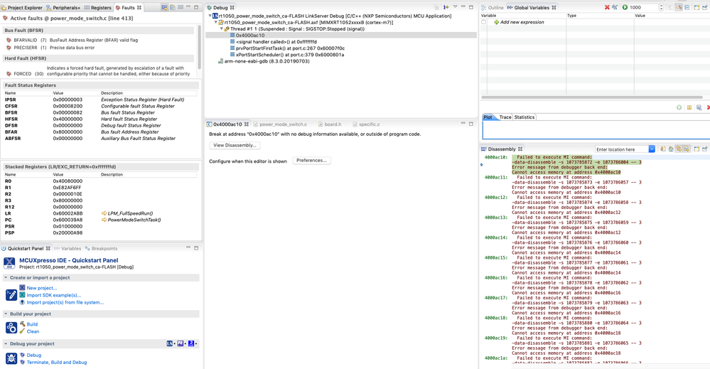

variable_andrew
Senior Contributor I
Hi danielchen@fsl‌,
On the Seeed board:
The the evkbimxrt1050_power_mode_switch_ca demo works without any error if I Link Application to RAM, so it appears the issue is specifically related to running from FLASH.
Can you confirm the demo works for you on the RT1050 EVK board when linked to flash?
Are you able to test the RT1050 EVK w/ QSPI NOR FLASH (like the one from the RT1020EVK)?
For the errors I'm seeing when running from FLASH:
When I update specific.c for what I believe to be proper FlexSPI Speeds for this board (133MHz), and then run, AFTER I choose a mode which requires changing the clocks ->  I get the error I put in the image in the previous post, segfault:
Active Fault @ power_mode_switch.c line 413;
BFARVALID (7) BusFault Address Register BFAR valid flag
PRECISERR (1) Precise data bus error
FORCED (30) - forced hard fault
Register LR is at LPM_FullSpeedRun() at memory location 0x60002ABB
Register PC is at PowerModeSwitchTask() at memory location 0x600039A8
Here's teh screenshot again:
If I DON'T change the FlexSPI div settings in specific.c (which would mean overclocking the FlexSPI FLASH by 2x) - also an imprecise data bus error (2) forced hard fault, LR at 0x600026A9.
Could you please confirm the demo works for you from FLASH - like the IS25LP064A-BLE FLASH used on the rt1020evk?

I previously asked about App_PrintRunFrequency discrepancy.
I then realized - the app starts w/ UsbPll1 pfd0 == 22 from clock config by default, and doesn't update that setting in code on init because of an #if XIP lin in clock config.
So you won't see the actual frequency preferred by specific.c until changing modes AWAY from overrun, and then back to overrun. Then everything lines up.
