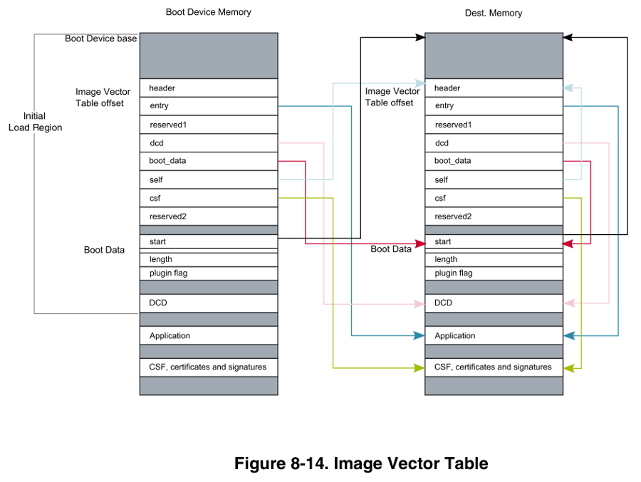

On page 377 of the RT1050 reference manual I find this figure:
I need more explanation (since there's nothing in the document).
What is Boot Device Memory? Is it correct to assume that the memory is where the bootable image is stored (in my case the QSPI)?
What is the Dest. Memory? Is it correct to assume that it is the memory from which the binary is run (in my case the ITCM or DTCM)?

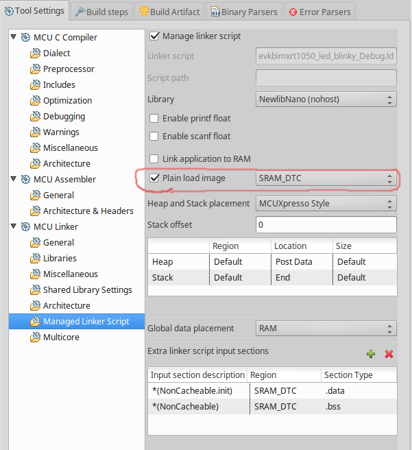

Setting as follows:
I get an image that is all in ram but that is mapped in the flash.

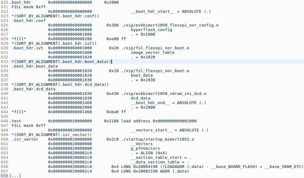

and map file is:
As you can see ivt is placed in flash, while .text (and also vectors) in DTCM.
Image 8-14 on page 377 suggests that ivt should be copied to Dest. Memory (I suppose from the rom bootloader), in fact, it also appears there. In addition, the arrows refer to Dest. Memory. Is this argument correct?

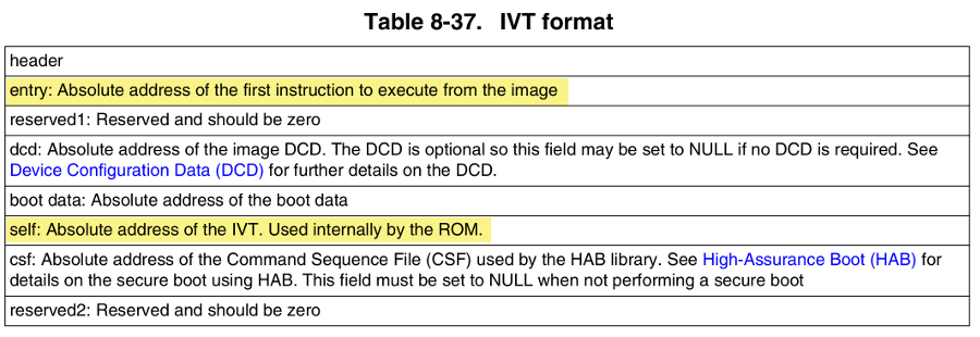

The IVT structure is depicted here:

As you can see IVT self is populated with the address of IVT structure itself, that is in FLASH, contrary to what the image 8-14 on page 377 suggests, from which it can be deduced that self should point inside the destination area.
And another inconsistency:
entry should be the address of the first executable instruction. Here it is valued as the address of the vectors:

This seems to me an error. I would have populated entry with the value ResetISR which is the actual entry point. Something like this:
extern void ResetISR(void);
#if defined(XIP_BOOT_HEADER_ENABLE) && (XIP_BOOT_HEADER_ENABLE == 1)
#if defined(__CC_ARM) || defined(__GNUC__)
 __attribute__((section(".boot_hdr.ivt")))
#elif defined(__ICCARM__)
#pragma location=".boot_hdr.ivt"
#endif
 * IVT Data
const ivt image_vector_table = {
 IVT_HEADER, /* IVT Header */
 (uint32_t)ResetISR, /* Image Entry Function */
 IVT_RSVD, /* Reserved = 0 */
 (uint32_t)DCD_ADDRESS, /* Address where DCD information is stored */
 (uint32_t)BOOT_DATA_ADDRESS, /* Address where BOOT Data Structure is stored */
 (uint32_t)&image_vector_table, /* Pointer to IVT Self (absolute address */
 (uint32_t)CSF_ADDRESS, /* Address where CSF file is stored */
 IVT_RSVD /* Reserved = 0 */
Is this conjecture correct?
