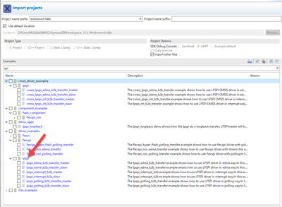

Hi All.
I'm new with NXP's i.MX RT1060 MPU.
Now I'm using MIMXRT1060-EVK for software development.
And I want to use SPI to communicate with external motor driver.
To use SPI I want to refer the sample code, but I don't know the difference of flexspi, lpspi and cmsi_lspi.
What should I use for usual SPI communication?
I want use as master SPI.
899 Views
jeremyzhou

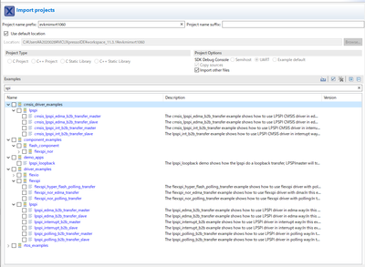

1)What should I use for usual SPI communication?
-- According to your statement, I'd highly recommend you to refer to the lpspi demos.

kenji
Hi, Jeremyzoh-san.
I refer to it! Thank you.
