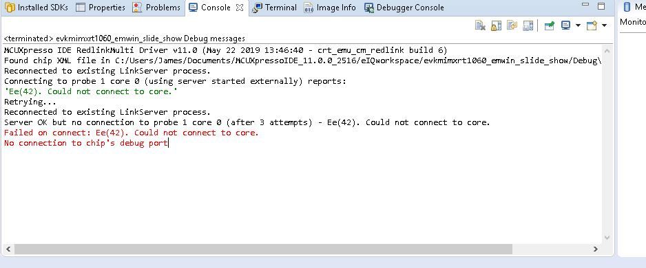

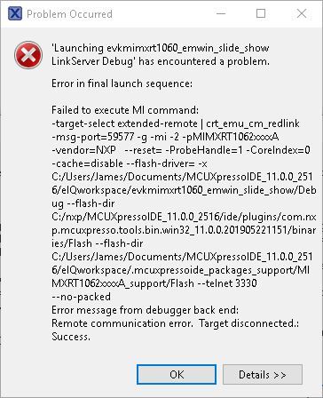

Trying to get the demo lab setup for the eIQ virtual event. Started with a new RT1060 EVK board. Installed the camera, lcd display and then wanted to do basic checkout before installing any of the lab demos. Board powers up from USB connection and blinky runs (green user led blinks) - first test, load hello world to prove that the board is communicating.
Board fails with the folowing errors displayed in MCUxpresso:
Dialog box message:
Error in final launch sequence:
Failed to execute MI command:
-target-select extended-remote | crt_emu_cm_redlink -msg-port=51856 -g -mi -2 -pMIMXRT1062xxxxA -vendor=NXP   --reset= -ProbeHandle=1 -CoreIndex=0 -cache=disable --flash-driver= -x C:/Users/James/Documents/MCUXpressoIDE_11.0.0_2516/eIQworkspace/evkmimxrt1060_hello_world/Debug --flash-dir C:/nxp/MCUXpressoIDE_11.0.0_2516/ide/plugins/com.nxp.mcuxpresso.tools.bin.win32_11.0.0.201905221151/binaries/Flash --flash-dir C:/Users/James/Documents/MCUXpressoIDE_11.0.0_2516/eIQworkspace/.mcuxpressoide_packages_support/MIMXRT1062xxxxA_support/Flash --telnet 3330 --no-packed
Error message from debugger back end:
Remote communication error.  Target disconnected.: Success.
MCUxpresso console window:
MCUXpresso IDE RedlinkMulti Driver v11.0 (May 22 2019 13:46:40 - crt_emu_cm_redlink build 6)
Found chip XML file in C:/Users/James/Documents/MCUXpressoIDE_11.0.0_2516/eIQworkspace/evkmimxrt1060_hello_world/Debug\MIMXRT1062xxxxA.xml
Reconnected to existing LinkServer process.
Connecting to probe 1 core 0 (using server started externally) reports:
'Ee(42). Could not connect to core.'
Retrying...
Server OK but no connection to probe 1 core 0 (after 3 attempts) - Ee(42). Could not connect to core.
Failed on connect: Ee(42). Could not connect to core.
No connection to chip's debug port
This was with MCUxpresso build "MCUXpresso IDE v11.0.0 [Build 2516] [2019-06-05]" on a Windows 10 Core I7.
SDK build version: RT1060 - 2.6.2 238 2919-07-11 with required eIQ mods as described in  https://community.nxp.com/docs/DOC-344227
Reinstalled MCUxpresso over the existing install as this was indicated to solve the problem by one of the community notes. This left MCUxpresso in a state where it would not start correctly. (side note: get you installer guys to fix there installer) .
Next uninstalled MCUxcpresso using control panel/programs/... (uninstaller left the mcu directories however - which were then deleted) Then reinstalled MCUxpresso again. Starts correctly, still has the above problem. Possible driver problem?
Considered a possible USB port problem - moved to new USB port - same problem. No USB hubs involved. Also tried both USB3 and USB2 ports. No difference.
Installed MCUxpresso build v11.0.0 [Build 2516] [2019-06-05] on to my Mac/OsX system. Installed newly downloaded SDK for RT1060 (build 238 2019-07-11) from the NXP website. Loaded the hello world demo - build, selected debug - app built
and loaded and ran as it should.
What is the problem with the windows version of MCUxpresso?
Thank you.

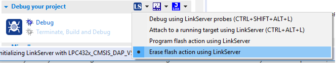

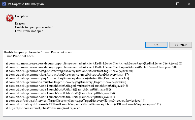

Since I am having the same problem as James, I just tried your suggestion. The "Probe discovered" dialog looks just like yours, with LPC-Link2 detected:
but then:
Latest MCUXpresso 11.0.1.
Chris

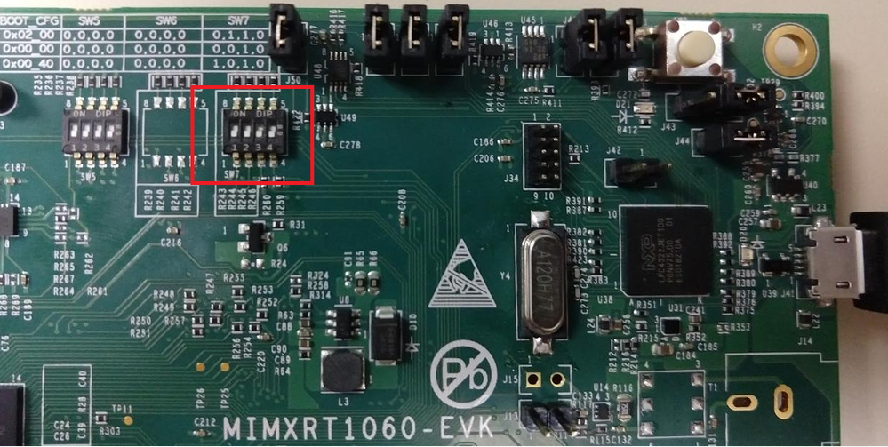

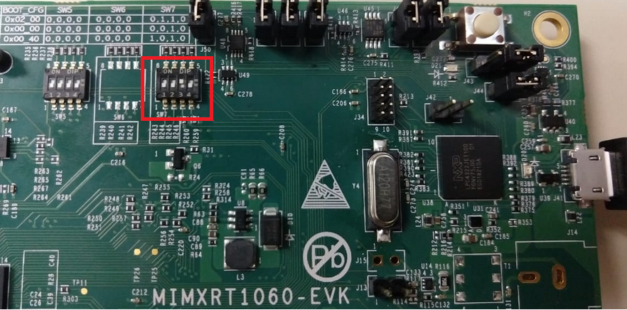

Can you please try to mass erase the flash booting from the fuses:
1. Configure the board to boot from fuses(SW7: 0000, see reply https://community.nxp.com/message/1205879?commentID=1205879&et=watches.email.thread#comment-1197394)
2. Power up the board
3. Open MCUXpresso and select mass erase
4. Wait until it's mass erased
5. Disconnect board
6. Configure the board to boot from flash (SW7:0010)
7. Flash your board as usual
-JC

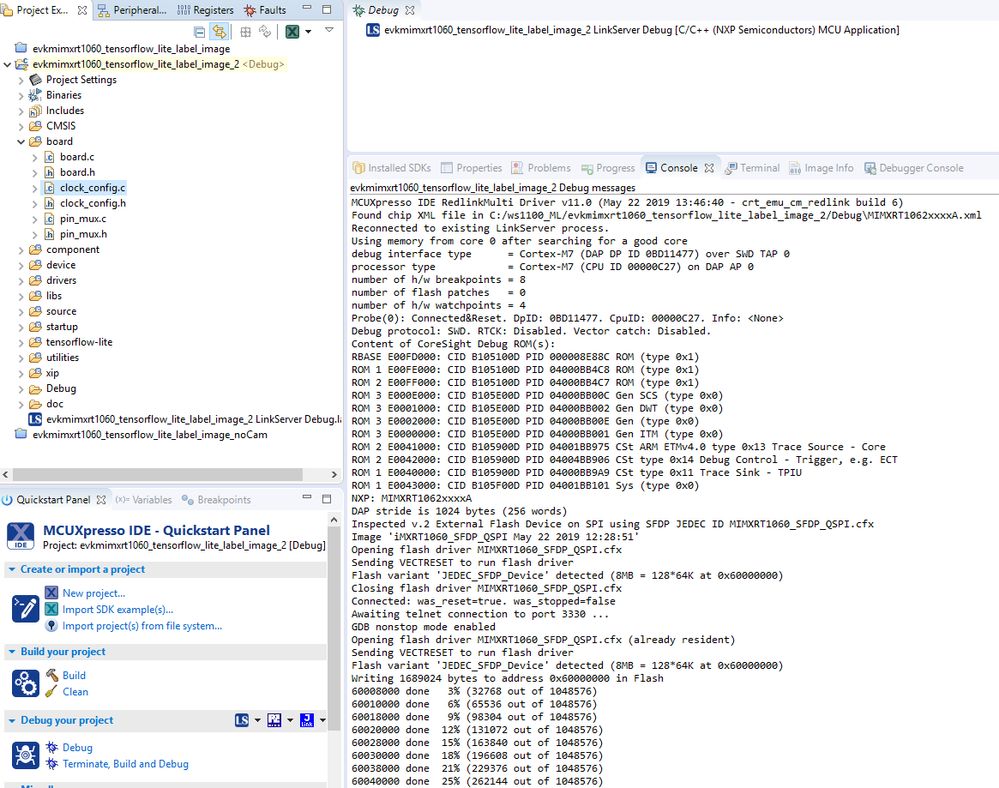

Using my OSX system running MCUxpresso, I was able to reload the blinky application, no change in voltage or current.
Loading the emwin slideshow application, the voltage was unchanged, but current increased to 0.30A which is reasonable since the application enables the touch display.
Reloading the blinky application, voltage was unchanged at 5.05V and current returned to 0.11A which is as expected.
Given the power supply can source 3A current, these fractional amp measurements are believable. Also the power supply did not indicate current limiting during the entire investigation.
I then attempted to load an application using my Windows 10 system, MCUxpresso and the same two applications. The USB cable, power connections and power supply were not changed. Only the connection of the USB cable to the Windows system. The problem reported above in detail was still present - the same error messages were reported by MCUxpresso.

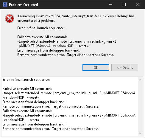

jtmiii

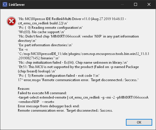

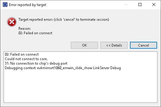

Switch SW7 was set to 0010 (factory default - unchanged) out of the box. Checked this before
I started - since I have seen other boards in the past arrive with non-default options set
(won't name vendor - not NXP).
Moved SW7 to be 0000 (all switches toward center of the board), did power on reset
to the board and started MCUxpresso.
Attempted to load unmodified emwin slide show application (which I have been able to load
from both MAC OSX and Linux Ubuntu) and received the following error messages (which are
the same as I had been receiving on windows).
As additional information, the Windows system I have has 8 USB ports on the mother board.
4 USB 2.0 and 4 USB 3.0 - in an attempt to eliminate either a bad port or incompatibility
between the board and the USB version, I have repeated this with the 1060 board connected
to each port. No change.
Dialog boxes from the reported error:
Top:
Middle:
Bottom:
Console:

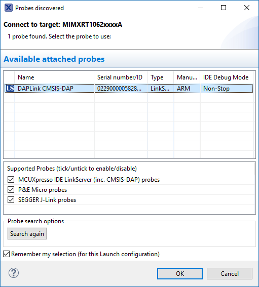

jc_pacheco
James,

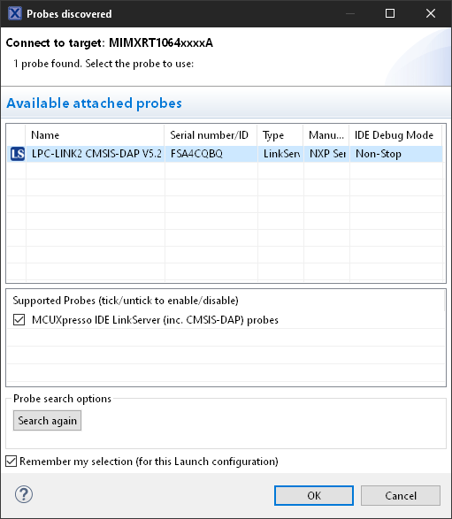

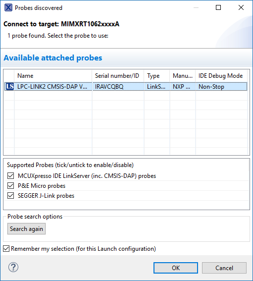

Just as a quick test... Can you try booting from the fuses mode and then try to flash the device using MCUXpresso in Windows?
This is done by configuring the SW7 switch to 0000:

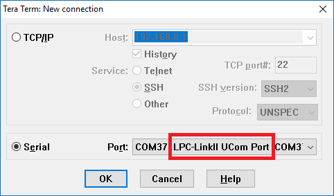

Please confirm this is how your board is enumerated during probe discovery:
If it works, then switch back to Internal boot mode(SW7 configuration 0010):
Please let me know if this worked for you. Either way, I'm tracking internally this issue to report it to our tools team.
JC

jc_pacheco

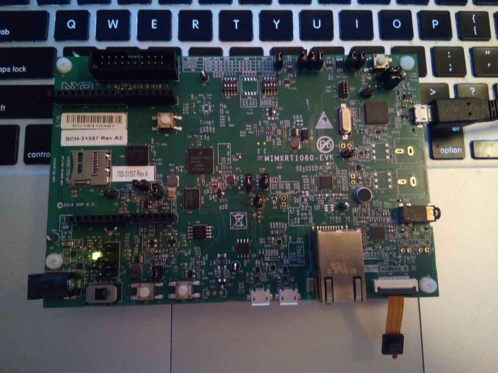

Hi James,
Could you please provide an image of your setup? The LPC-Link2 port is J4, the other ports can't be used to flash the board.
Just to make sure, do you have the latest LPC-Link2 Windows driver?

The problem is that I can not program the board from windows. I also have a RT1064 EVK board that exhibits identical problems with the Windows version.
I will try the linux version of MCUxpresso later tonight and confirm it works.
James
