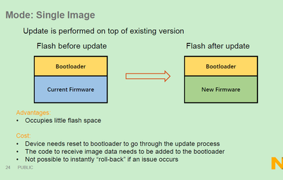

I try to build the second bootloader, base on the MCU secure bootloader (SBL) project.
I set the single image mode ( SBL ), without application in slot1
result :
flash the "hello world" image to the flash. offset 0x100000.
tools : MCU boot utility.
MCUxpress project setting " XIP_BOOT_HEADER_ENABLE=0 " "XIP_BOOT_HEADER_DCD_ENABLE=0"
Have some document about the SBL application building?

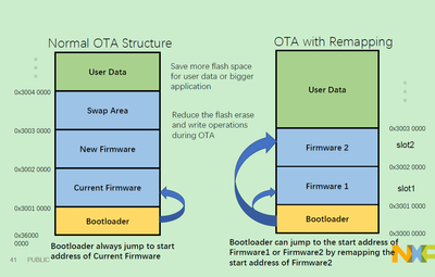

For the first time to test the SBL, we need to download the first image to the board to run the test. Using the MCUBootUtility tool to download the app1.bin to the first slot of the board, the default location of the slot1 is the flash_offset+0x100000 to flash_offset+0x200000, the whole slot size is 1MB.
About the firmware, I checked your bin, the reset handler is 0X301004E1, it is above 0X100000, I think it is OK.

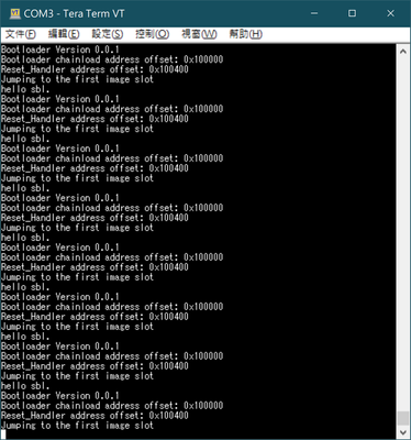

If you still have issues, please also share the screenshot, the log is very important to analyze the issues.

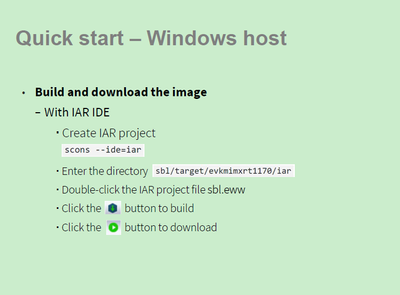

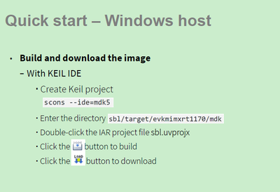

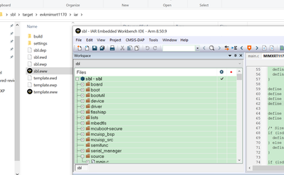

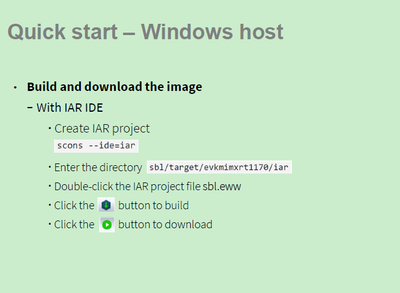

  For IAR and MDK, you need to do this operation:
Then you will find the related project is not empty:
About the application note, not only sign the code, it also need to add the header, but until now, I still don't have the application example source code, internal side still recommend us to wait until it is published, at that time, the application example will also be added to the published version.

  In your picture, you are using the MCUBootUtility download the code, do you download the SBL, not the app? If yes, now, exit the serial download mode, enter the internal boot mode, you will run the SBL detail function, you just need to use the SBL function to update your app firmware.

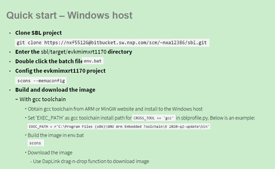

First, I download build the SBL.bin file, through the MSD upload second bootloader.
and then upload the application the the slot1 offset 0x10000 by MCUBootUtility. as the picture show.
"you just need to use the SBL function to update your app firmware." <---- What does that mean?
maybe I can upload the scons setting for you. using the EVK1170.
if you need more information please tell me, thanks.
0426.7z : scons setting.
evkmimxrt1170_hello_world_demo_cm7.7z : MCUXpresso IDE v11.3.1 with SDK2.9.1 example, " XIP_BOOT_HEADER_ENABLE=0 " "XIP_BOOT_HEADER_DCD_ENABLE=0"
