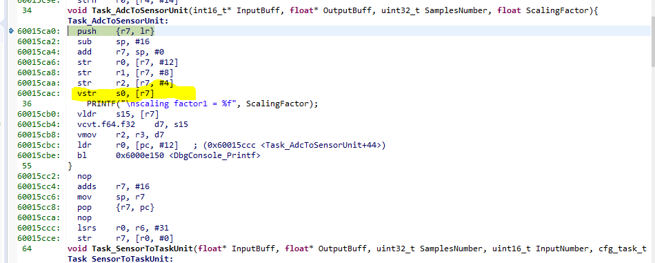

I have a poroblem with passing flaot parameter to function.

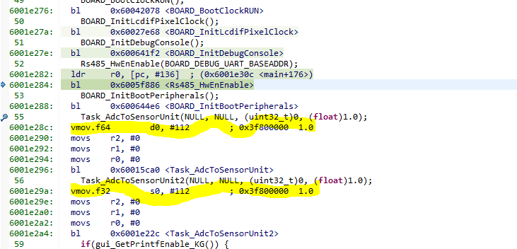

There are two functions  wich have the same body. Both print float parameter: ScalingFactor = 1;
First one prints wrong value = 0, the second one good value = 1
    Task_AdcToSensorUnit(NULL, NULL, (uint32_t)0, 1.0f);
    Task_AdcToSensorUnit2(NULL, NULL, (uint32_t)0, 1.0f);
This one is defined in main module
void Task_AdcToSensorUnit2(int16_t* InputBuff, float* OutputBuff, uint32_t SamplesNumber, float ScalingFactor){
PRINTF("\nscaling factor = %f", ScalingFactor);
This one is defined in other module
void Task_AdcToSensorUnit(int16_t* InputBuff, float* OutputBuff, uint32_t SamplesNumber, float ScalingFactor){
PRINTF("\nscaling factor1 = %f", ScalingFactor);
I checked assambly code and have noticed that first one is passing parameter by double precision register d0 (Pic1), the second one by single precison register s0 (pic1). But both of them to print value are using single precision register s0 - (Pic2 and Pic3)
The library i am using is  newlib, floating point: FPv5-D16(Hard ABI).
What could be the problem?

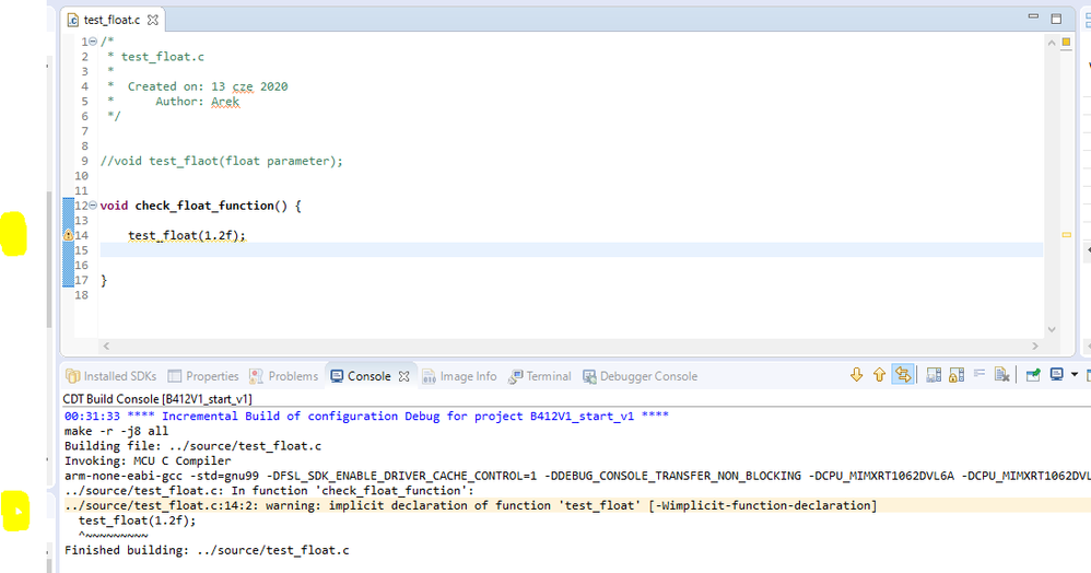

Maybe I said it wrong. Perhaps such functionality is missing. I mean information about warnings.
An example below. If you create function, then compile the file, you will get warning in cosole and inside the file.
But if you miss them and compile once again this information will disappear and the function will not work properly.
Is it possible to make expresso to keep information about warnings for all file even they are not compile in last compilation?

I've found the problem.
If the function body is in another module (file) and you forget to attach its declaration (#inclue ....), it does not work properly. Of course, we receive a warning at the first compilation. However, in the following you can not see it. By the way, can this feature be turned off in expresso?
I'm talking about functions like:
void function(float dana) { .... }
