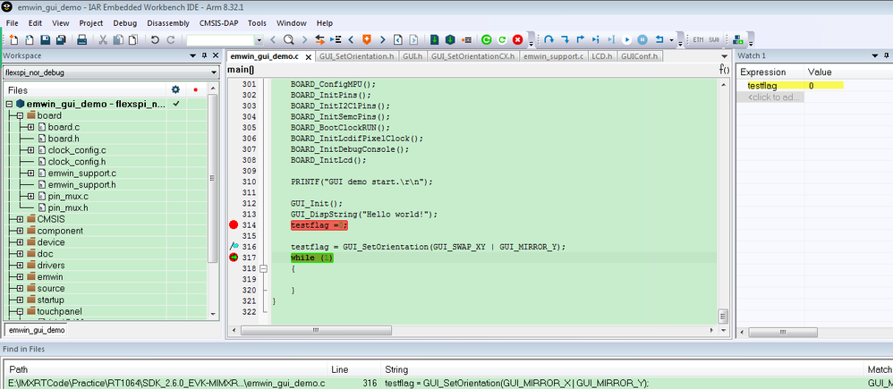

  Do you try to write a small code to test the GUI_SetOrientation() ?
  Take an example, just use the very simple code, this is my test result, we can find the return flag is 0:
