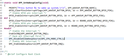

In fact, I had read the note and try those code (if you check those code in project "evkmimxrt1170_power_mode_switch_bm_core0" you will see the function "APP_SetWakeupConfig" same as 4.9.1 GPIO as a wakeup source ), but it's not work.
as below picture, the #if - #endif is I try to added. The "BOARD_USER_BUTTON2_GPIO_PIN" are 3U that I try to config GPIO13_IO3
So, you mean GPIO_SNVS_00 CAN NOT use to GPIO function even though user manual show function ALT5 - GPIO13_IO3?

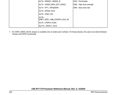

I find the description in "i.MX RT1170 Processor Reference Manual, Rev. 0, 12/2020" 11.1.2 Pin Assignments page450 "For GPIO_SNVS_00-09, tamper is available only on select part numbers. On those devices, the users can select between Tamper and GPIO functionality".
Is this description wrong? Or the "select part numbers" was not RT1170?That's confuse me...
