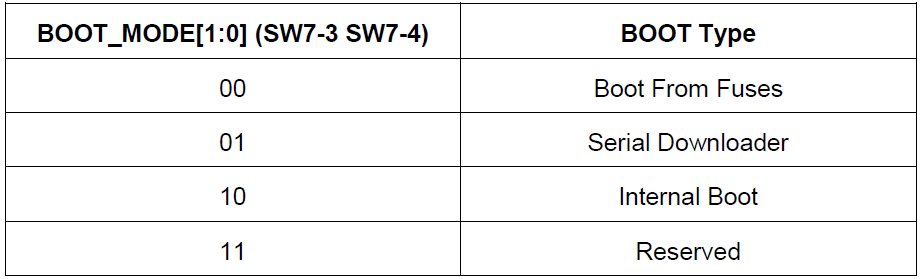

     I have one more doubt  https://www.nxp.com/docs/en/data-sheet/IMXRT1064CEC.pdf  page no 80  Boot mode configuration pins what is the use of these pins ?
    What is the use of fuse settings ?
Thanks & Regards,

jeremyzhou
Hi  Vasudhevan G
Thanks for your reply.
1) what is the use of these pins?
-- It's used to select the boot mode and boot-up device, as the below shows.
2) What is the use of fuse settings?
-- As same as the boot pins, the fuse setting is used to select the boot mode and boot-up device.
