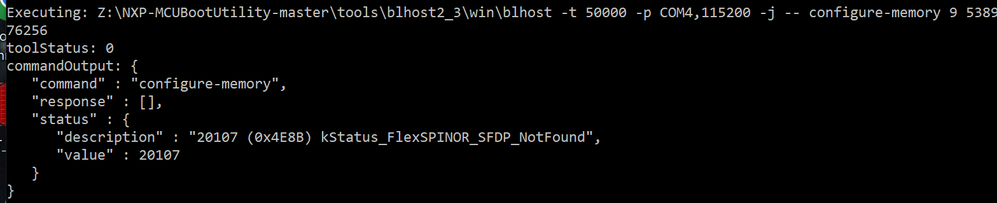

I tried to use FLEXSPI2 NOR flash & used MCUIDE sample LED program to flash over SPT for i.MXRT 1160 EVK as below,
I changed the flash base address to 0x60000000(since FLEX NOR SPI2 needs to be reside that memory address) & chose FLESPI2 configuration as below.
I could able to build the image , but while try to flash the image shows as SFDP not found.
blhost -t 5000 -u 0x15A2,0x0073 -j -- configure-memory 9 0x2000
"command": "configure-memory",
"response": [],
"status": {
"description": "20107 (0x4e8b) FlexSPINOR: SFDP Not Found.",
"value": 20107
blhost failed
Let me know is there any other modification needs to be adapt for FLEX SPI NOR2 ?

You connect Flash to GPIO_SD_B1[05:00] right?
Have you burnt below fuse region?
eFuse 0x940 FLEXSPI_INSTANCE =1
eFuse 0x9A0 FLEXSPI_PIN_GROUP_SEL =1
eFuse 0x9A0 FLEXSPI_CONNECTION_SEL =0

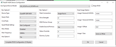

I have blown the FLEXSPI_PIN_GROUP_SEL  but not the FLEXSPI_INSTANCE fuse. I am selecting FLEXSPI2 using a GPIO override via the boot switches on the board. As I said in the original post, I can see (via an oscilloscope) the initial read happening on FLEXSPI2 when I attempt the boot. I can see it read the flash config block and then another read of roughly 4Kbytes. In fact if I deliberately corrupt the 0x42464346 tag at the start of the flash config block I can see the boot stop immediately after reading this tag (as it is now wrong). So I am confident all the boot parameters are correctly set.

Is it possible to make the MCUBootUtility write to my flash device connected to FLEXSPI2? Currently when I set it all up it is writing the image to the Octal flash device which is still connected to FLEXSPI1 on my EVK board (I will eventually replace this with a Hyper RAM). I cannot test a boot from this device since it is connected to the Primary pins of FLEXSPI1 and I have blown the fuse to specify the boot from the secondary pins.....

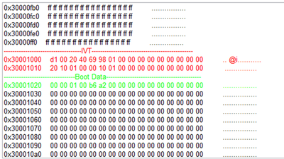

However I have replicated in my code the IVT and Boot Data I see MCUBootUtility create and written it to the FLEXSPI2 device along with the image (as follows)
MCUBootUtility IVT and Boot Data:
My flash device on FLEXSPI2 contains the same,
yet it still will not boot with no change in the behaviour! Any more throughts?

Set MCUBootUtility / Tools / FlexSPI XIP Region to 1, then it will download app into FlexSPI2 flash

Thank you for the information, however if I make this change I cannot connect to the target board, I get the following error,
I suspect this may be because my flash device is connected to the alternate pins for FLEXSPI2 rather than the primary pins. Is there any way around this?

1.Select below opt and try again.
2.BootROM can support both XIP and Non-XIP image, you can just provide raw image to MCUBootUtility, tool can add necessary header for ROM boot

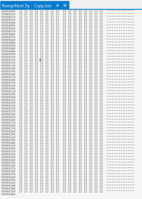

If I change the settings as you suggest then the MCUBootUtility does get further, however it later hangs whilst attempting to erase the area of the flash which will contain the FLEXSPI config block (0x400). I have attached a log (MCUBootUtilLog.txt) of the commands and responses from the CMD window.
I know the flash chip is erased (I have erased it with my code and it reads back as 0xFFFFFFFF) so I suspect MCUBootUtility may be setting the clock speed of the FLEXSPI2 interface too high. Due to the prototype wiring to connect the flash chip to the EVK board it will only work up to 88MHz. What clock speed does the MCUBootUtility configure the FLEXSPI? Is it possible to change it? I did try setting the "Max Frequency" in the FlexSPI NOR Device Configuration window to 30MHz but I have a feeling this only applies to the generation of the Flash config block as it makes no difference to the behaviour.
This is the contents of flexspiNorCfg.bin as read back by MCUBootUtility command, "blhost -t 5242000 -p COM4,115200 -j -- read-memory 1610613760 1024 Z:\NXP-MCUBootUtility-master\tools\blhost2_3\win\vectors\flexspiNorCfg.dat 9" which is clearly not correct for erased flash.
Does the MCUBootUtility store the generated flash config block in a file anywhere? I can see it generate the bootable image as a .bin file, but this file does not contain the flash config block it only has the IVT and boot data appended to the binary image.

jay_heng
You can try 'Write (Auto Erase)' button in Boot Device Memory sheet, not to use 'All-in-one Action' button.
flash config block is generated by tool dynamically
