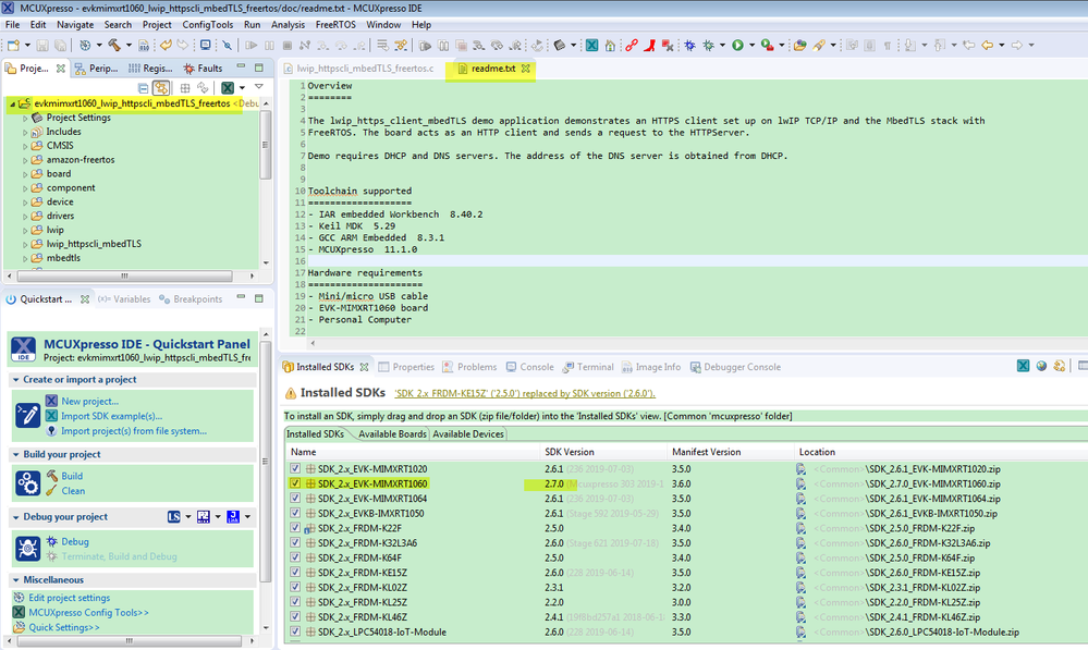

I'm using MCUXpresso 11.01 for the MIMXRT1062DVJ6A, and MCUXpresso SDK 2.6.2. I've got LWIP 2.1.2 and mbedTLS 2.13.1. What HTTPS client library can I use with this? The immediate need is to do GETs and PUTs.

kerryzhou
Hi Jeff Thompson
  Do you add the SDK 2.7.0 in the installed SDKs?
  Then you can import the official SDK again in your IDE.
About the document, you can refer to the project readme under project doc folder.
Then, you can check more details from the code and the SDK test result. From the readme, you can find this client project also support the write to server and read from server functions.

Hi Jeff Thompson ,
    Please download the newest SDK 2.7.0 from this link:
http://mcuxpresso.nxp.com/en/select
 you can find the related http client in the lwip folder:
