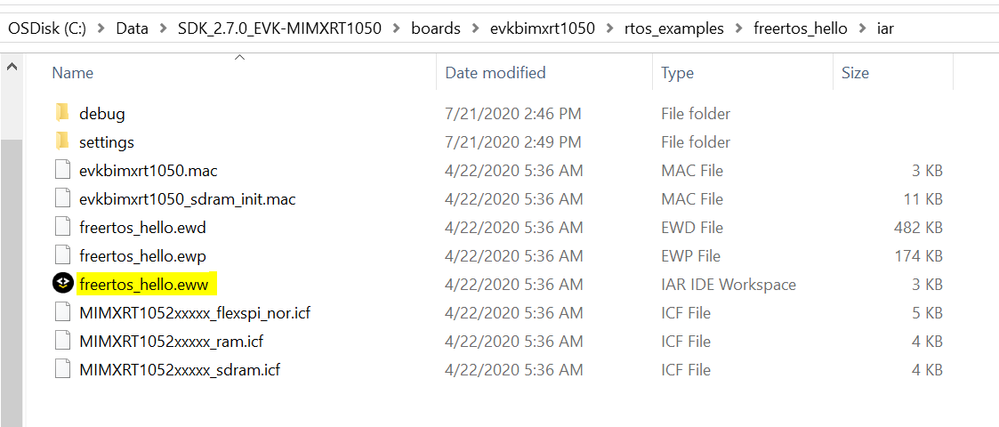

nxf64589
Hi Aniket
  1. When downloading the SDK package, make sure you have either “All Toolchains” selected or “IAR”. Also make sure the Amazon FreeRTOS middleware option is selected. You can also use “Select All.”
  2. Unzip the SDK package and navigate to \boards\evkbimxrt1050\rtos_examples then choose the example you’re interested in.
  3. There will be a IAR folder with a project file ending with .eww. This is the project you can load.
Below is a screenshot of the IAR file folder with the project file highlighted using the "freertos_hello" example.
Let me know if you have any other issues or questions!
