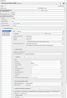

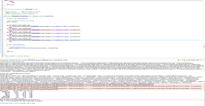

Using MCUXpresso version 11.4 I am trying to create SAI1 and SAI2 for ISO audio streaming using the Peripherals tool.  Everything using the defaults.  After updating and compiling the code I receive the following error:
/Applications/MCUXpressoIDE_11.4.1_6260/ide/plugins/com.nxp.mcuxpresso.tools.macosx_11.4.0.202103011116/tools/bin/../lib/gcc/arm-none-eabi/10.2.1/../../../../arm-none-eabi/bin/ld: ./source/generated/usb_device_composite.o: in function `USB_UpdateInterfaceSetting':
/Users/xyz/Documents/MCUXpressoIDE_11.4.1_6260/workspace/evkmimxrt1064_speaker_dev_audio_speaker_bm/evkmimxrt1064_mark_hello_world/Debug/../source/generated/usb_device_composite.c:857: undefined reference to `USB_DeviceInterface1AudioStreamingSetInterface'
My goal is to have a single USB Interface for multiple SAI.  Is using the 'Peripherals' tool the best way of accomplishing this?
Thanks.
Mark

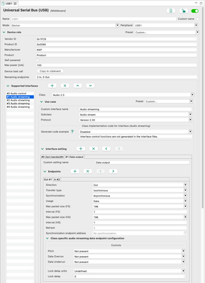

The error is related to USB when configuring multiple ISO streaming endpoints for USB Audio.  Screenshots attached.

kerryzhou
Hi @mrecoskie ,
   Your last picture shows you lack the USB_DeviceInterface1AudioStreamingSetInterface, please check your code, whether you have that API  or not? After you modify the CFG configuration, you need to update the code. If the API already can be found, it should the related heard include issues, you can check your project path, whether you include the related path about your API file.
Wish it helps you!
kerry

kerryzhou
Hi @mrecoskie ,
   Sorry for my later reply!
   I find your code, usb_device_interface_0_audio_contol.c contains the USB_DeviceInterface4AudioStreamingSetInterface,
So, I think you can copy this API, then set it for the interface1,2,3.

I copy it, and use the related name in the usb_device_compoiste.c:
    case USB_INTERFACE_1_AUDIO_STEAMING1_INDEX:
        ret = USB_DeviceInterface1AudioSteaming1SetInterface(g_UsbDeviceComposite.interface0AudioControlHandle, alternateSetting);
        break;
    case USB_INTERFACE_2_AUDIO_STREAMING_INDEX:
        ret = USB_DeviceInterface2AudioStreamingSetInterface(g_UsbDeviceComposite.interface0AudioControlHandle, alternateSetting);
        break;
    case USB_INTERFACE_3_AUDIO_STREAMING_INDEX:
        ret = USB_DeviceInterface3AudioStreamingSetInterface(g_UsbDeviceComposite.interface0AudioControlHandle, alternateSetting);
        break;
    case USB_INTERFACE_4_AUDIO_STREAMING_INDEX:
        ret = USB_DeviceInterface4AudioStreamingSetInterface(g_UsbDeviceComposite.interface0AudioControlHandle, alternateSetting);
        break
Then build again, the issue is not happen, I think it is the CFG issues which didn't generate the related API.
