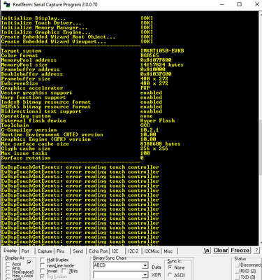

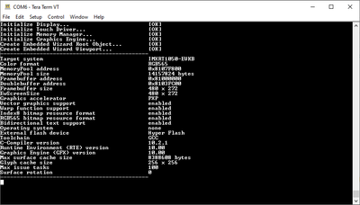

I found this issue using the MIMXRT1050-EVK  with RK043FN02H-CT display (see terminal captured image here below)
The EVK board don't show images and program is not working

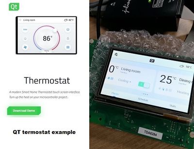

I'm trying the sample evkbimxrt1050_ew_gui_smart_thermostat from SDK_2_10_0_EVKB-IMXRT1050, using MCUXpresso IDE v11.4.1_6260.

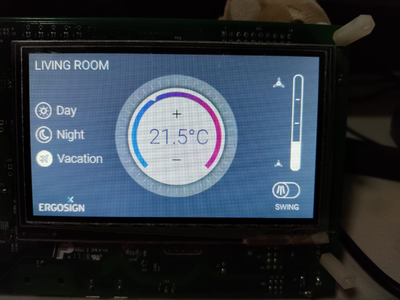

I checked also with the example on QT https://www.qt.io/microcontrollers-nxp
In this case (as you can see in the photo below) the board works fine.
Have you any suggest about? Thank you

- my EVK board is right configured, note that when I tried with QT example this is working well.

In addition, the serial log shows that sample seems start, but it stops into while error.

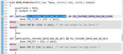

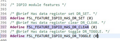

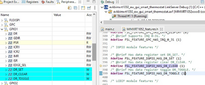

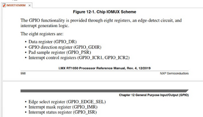

As on i.MX RT1050 Processor Reference Manual, page 998-999, here below the GPIO registers allowed on RT1050 family
but on evkbimxrt1050_ew_gui_smart_thermostat from SDK_2_10_0_EVKB-IMXRT1050, the IGPIO module is configured to use CLR, SET and TOGGLE register (instead of directly DR register)
I  see that GPIO library is provided for both method
I tried to modify the IGPIO module configuration
and now Termo and all Display examples are working
