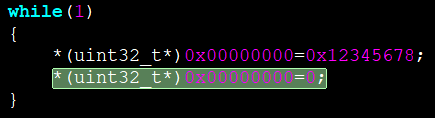

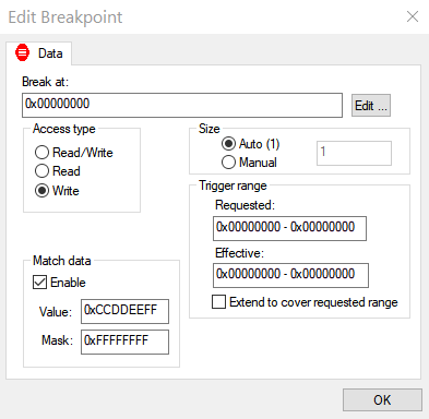

Hi Kerry,
 I am using IAR EWARM 8.50.1, but the problem was there on older versions.
The breakpoint triggers _every time_ memory location 0x00000000 is written to (so both lines in the test code).
But it should _never_ be triggered with the configuration above.
I am using a J-Link.
IAR know it's a problem, but I want to know if anybody has tested this feature on a different IDE.
Chris.

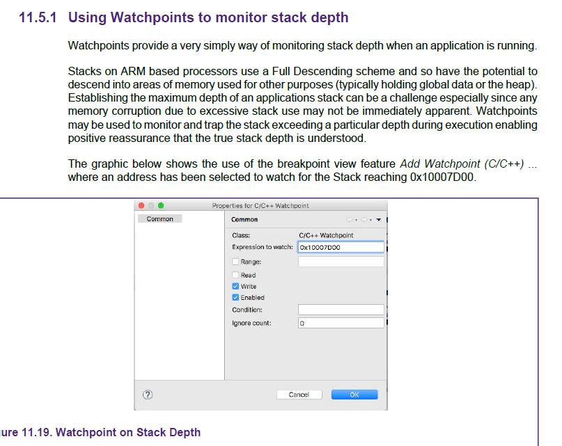

  About the other IDE, I checked the MCUXPresso user manual MCUXpresso_IDE_User_Guide.pdf under:
C:\nxp\MCUXpressoIDE_11.1.0_3209
, it has this description:
If you have interest, you can try the MCUXpresso IDE by refering the user manual.
Kerry

Hi Kerry,
  That MCUXpresso example is not the same.
It is a breakpoint on data write to 0x10007d00.
I require data write of a value to 0x10007d00. So a data match breakpoint.
The example given for MCUXpresso does work on IAR. It is the data match that I am asking about.
Has anybody tested data match on MCUXpresso?
Chris.
