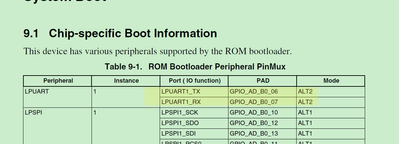

3. If you want to use the serial download mode, you need to use the correct RT1020 UART interface:
kerryzhou_0-1655949150827.pngkerryzhou_1-1655949246364.pngkerryzhou_2-1655949269033.png
If you use other interface for GPIO_AD_B0_06 and GPIO_AD_B0_07, you need to disconnect J25, J26.
You also need to let the board enter the serial download mode instead of the internal boot mode. Then you can use the MCUBootUtility to download it if your board doesn't have issues.

  So, you need to make sure:
  Then, the MCU-LINK UART_RX -> RT UART_TX,
                  MCU-LINK UART_TX->RT UART_RX.
You also can connect the MCU-LINK UART_TX and TX together, then send data to it's own COM, whether it can receive it's own data, just the self testing at first, after it works, then you can test it with the RT board, please note, the RT board also has the on board VCOM port, make sure the PC side select the correct COM port, if you are using the MCU-LINK, you need to make sure the PC tool select that correct COM port.
