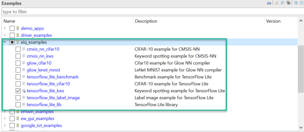

In the SDK_2.7.0_EVKB-IMXRT1050, it contains some eIQ machine learning demo projects, there's the tensorflow_lite_kws among them.
It's a keyword spotting example that is based on Keyword spotting for Microcontrollers and it deploys a deepwise separable convolutional neural network called MobileNet in this demo project. It can classify a one-second audio clip as either silence, an unknown word, "yes", "no", "up", "down", "left", "right", "on", "off", "stop", or "go".

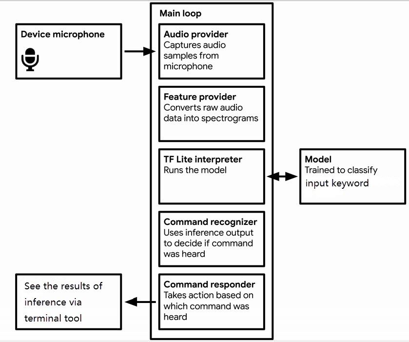

Figure 1 shows the components that comprise it.
Fig 1

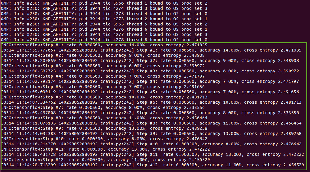

Once the downloading has completed, some more output will appear. There might be some warnings, which you can ignore as long as the command continues running. Later, you'll see logging information that looks like this (Figure 3).
Fig 3
This shows that the initialization process is done and the training loop has begun. You'll see that it outputs information for every training step. Here's a break down of what it means:
  • Step shows that we're on the step of the training loop. In this case, there are going to be 30,000 steps in total, so you can look at the step number to get an idea of how close it is to finishing.
  • rate is the learning rate that's controlling the speed of the network's weight updates. Early on this is a comparatively high number (0.0005), but for later training cycles it will be reduced 5x, to 0.0001, then to 0.00002 at last.
  • accuracy is how many classes were correctly predicted on this training step. This value will often fluctuate a lot, but should increase on average as training progresses. The model outputs an array of numbers, one for each label, and each number is the predicted likelihood of the input being that class. The predicted label is picked by choosing the entry with the highest score. The scores are always between zero and one, with higher values representing more confidence in the result.
  • cross-entropy is the result of the loss function that we're using to guide the training process. This is a score that's obtained by comparing the vector of scores from the current training run to the correct labels, and this should trend downwards during training.

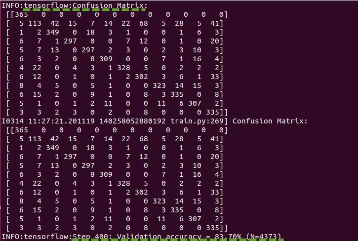

  • Confusion Matrix
    After four hundred steps, this information will be logged:
    The first section is a confusion matrix. To understand what it means, you first need to know the labels being used, which in this case are "silence", "unknown", "zero", "one", "two", "three", "four", "five", "six", "seven", "eight", and "nine". Each column represents a set of samples that were predicted to be each label, so the first column represents all the clips that were predicted to be silence, the second all those that were predicted to be unknown words, the third "zero", and so on.
    Each row represents clips by their correct, ground truth labels. The first row is all the clips that were silence, the second clips that were unknown words, the third "zero", etc.
    This matrix can be more useful than just a single accuracy score because it gives a good summary of what mistakes the network is making. In this example you can see that all of the entries in the first row are zero (Figure 5), apart from the initial one. Because the first row is all the clips that are actually silence, this means that none of them were mistakenly labeled as words, so we have no false negatives for silence. This shows the network is already getting pretty good at distinguishing silence from words.
    If we look down the first column though, we see a lot of non-zero values. The column represents all the clips that were predicted to be silence, so positive numbers outside of the first cell are errors. This means that some clips of real spoken words are actually being predicted to be silence, so we do have quite a few false positives.
    A perfect model would produce a confusion matrix where all of the entries were zero apart from a diagonal line through the center. Spotting deviations from that pattern can help you figure out how the model is most easily confused, and once you've identified the problems you can address them by adding more data or cleaning up categories.

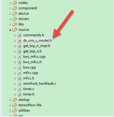

  1. In source/ds_cnn_s_model.h, replace the original model data with our new model.
  2. Update the label names in source/kws.cpp with our new ''zero'', ''one'', ''two'', ''three'', ''four'', ''five'', ''six'', ''seven'', ''eight'' and ''nine'' labels.

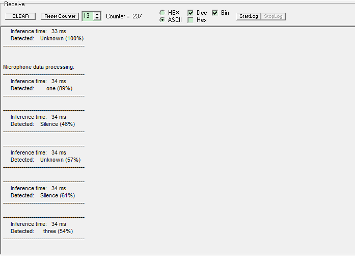

Figure 9 shows the testing I did, I've attached the model file, please give a try by yourself.
Fig 9

I cant find source/ds_cnn_s_model.h to replace the trained ds_cnn.h. I have searched online and in downloaded SDK_2.7.0_EVKB-IMXRT1050. There is no kws_tensorflow_lite example nor directory in it.
Appreciate your quick help here.
Hi ,
In the MCUXpreeso, expand the source fold on the Workspace window, you can see the ds_cnn_s_mode.h, as below shows.

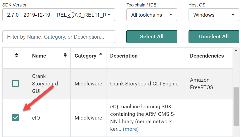

Thanks jeremyzhou for your quick response. My problem is that I cant find the project kws_tensorflow_lite. Your screen shot shows only the source folder. Not sure how you got the source folder in your IDE? Which project is it? Can you please share the link to that?
I have searched the downloaded MCUExpresso IDE workspace folder (C:\Users\B2F\Documents\MCUXpressoIDE_11.1.1_3241\workspace) which came with all examples, but no luck. Is there some kind of version mismatch?
As I point out at the beginning of this article, the tensorflow_lite_kws demo is from the SDK_2.7.0_EVKB-IMXRT1050, and you can download this SDK library via the below link. Then install the SDK library in the MCUXpreeso IDE, after that, you can load the  tensorflow_lite_kws demo.
So please give a try.
https://mcuxpresso.nxp.com/en/welcome
BR,
Jeremy

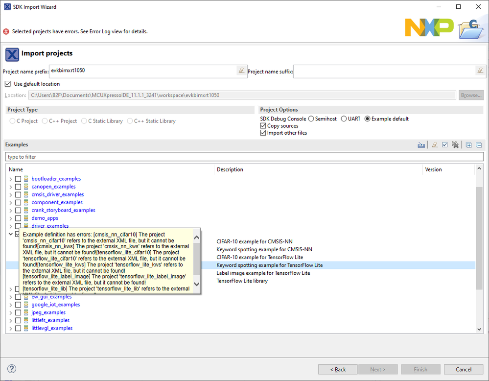

jeremyzhou‌, turns out I had followed all the steps but never selected eiq while building the SDK and hence it was missing.
Now that I have it, I cant import any of eiq examples including tensorflow_lite_kws
"tensorflow_lite_kws] The project 'tensorflow_lite_kws' refers to the external XML file, but it cannot be found!"
On eiq
Thanks for your reply.
It seems a bit weird, I've not encountered it before.pastedImage_1.pngird,
So I'd like to suggest you delete the installed SDK library and clean-up the projects in the workspace directory, then build a complete new SDK library (as below shows), then install it to the MCUXpresso IDE.
After doing that, reimport the eIQ demos again.
BR,
Jeremy
Yes Only selecting eid with tensorflow_lite_kws worked great. I am able to test deault Keywords and the 0 to 9. Just that the recognition is not very accurate.
