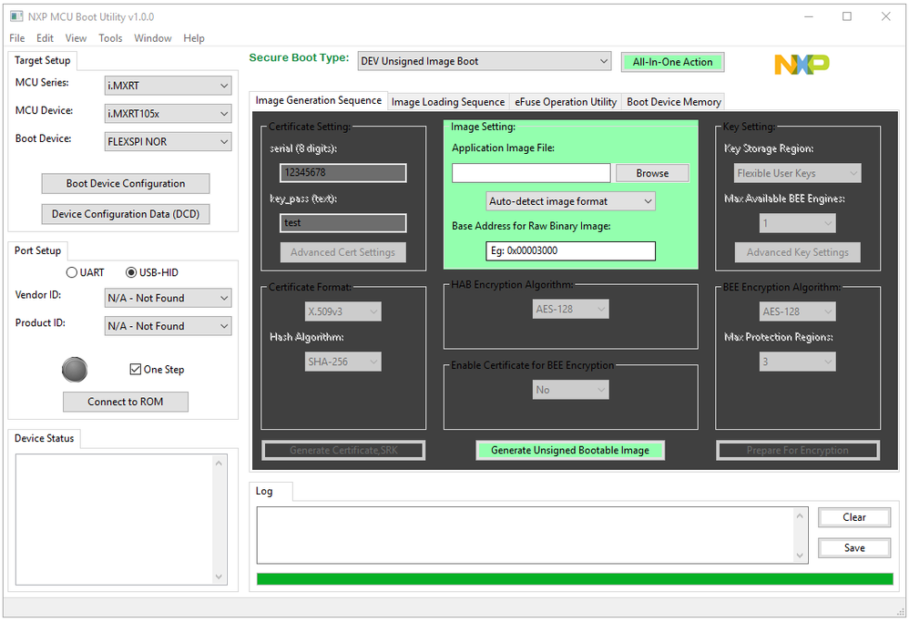

1 Introduction
  NXP-MCUBootUtility is a GUI tool specially designed for NXP MCU secure boot. Its features correspond to the BootROM function in NXP MCU. Currently, it mainly supports i.MXRT series MCU chips, Compared to NXP official security enablement toolset (OpenSSL, CST, sdphost, blhost, elftosb, BD, MfgTool2), NXP-MCUBootUtility is a real one-stop tool, a tool that includes all the features of NXP's official security enablement toolset, and what's more, it supports full graphical user interface operation. With NXP-MCUBootUtility, you can easily get started with NXP MCU secure boot.

4 Interface
  The following figure shows the main interface of the NXP-MCUBootUtility tool. The interface consists of six parts.
