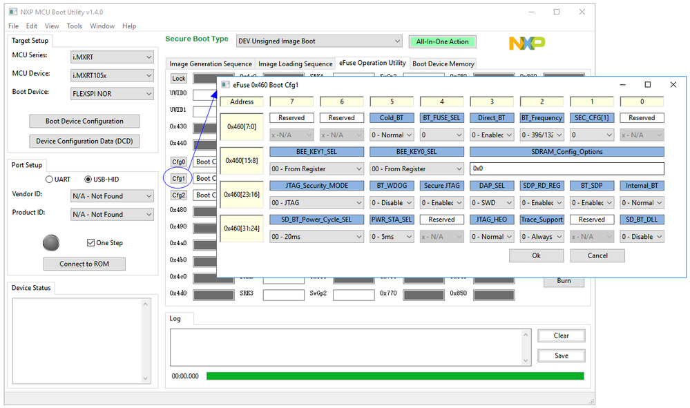

【v1.4.0】
Features:
> 1. Support for loading bootable image into uSDHC SD/eMMC boot device
>    支持下载Bootable image进主动启动设备 - uSDHC接口SD/eMMC卡
> 2. Provide friendly way to view and set mixed eFuse fields
>    支持更直观友好的方式去查看/设置某些混合功能的eFuse区域
Improvements:
> 1. Set default FlexSPI NOR device to align with NXP EVK boards
>    默认FlexSPI NOR device应与恩智浦官方EVK板卡相匹配
> 2. Enable real-time gauge for Flash Programmer actions
>    为通用Flash编程器里的操作添加实时进度条显示
