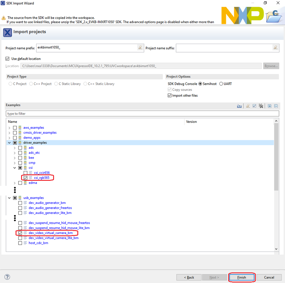

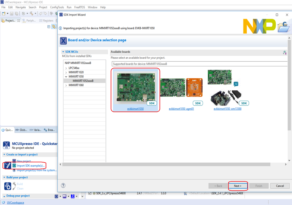

a) Open MCUXpresso IDE, and click on "Import SDK example" shortcut, select the "evkbimxrt1050" board and click on "Next" button.
b) Select the "driver_examples->csi->csi_rgb565" and "usb_examples->dev_video_virtual_camera_bm" examples, and click on "Finish" button.

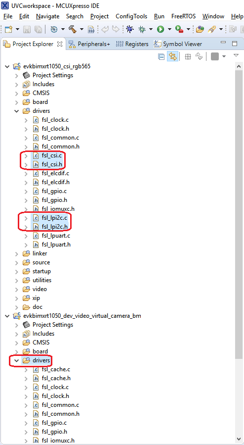

c) Copy the "fsl_csi.h", "fsl_csi.c", "fsl_lpi2c.h" and "fsl_lpi2c.c" files from the "drivers" folder of CSI project, to the "drivers" folder of the Virtual_Camera project.

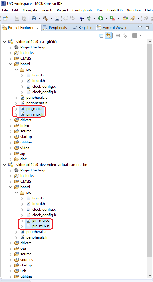

d) Copy the "pin_mux.h" and "pin_mux.c" files from the "board" folder of CSI project, to the "board->src" folder of the Virtual_Camera project, replacing the already included files.

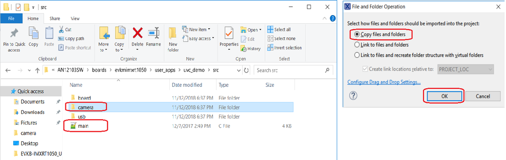

e) Copy the "camera" folder from AN12103 software package from the path below, to the Virtual_Camera project:
<AN12103SW\boards\evkmimxrt1050\user_apps\uvc_demo\src\camera>
Also copy the "main.c" file from AN12103 software package to the "sources" folder of the Virtual_Camera project.
Ensure selecting the option "Copy files and folders" when copying folders/files.

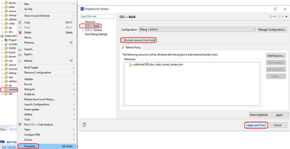

f) Right click on the recently added "camera" folder, and select "Properties". Then, on the "C/C++ Build" menu, remove the checkbox "Exclude resource from build" option, and then click on "Apply and Close" button.

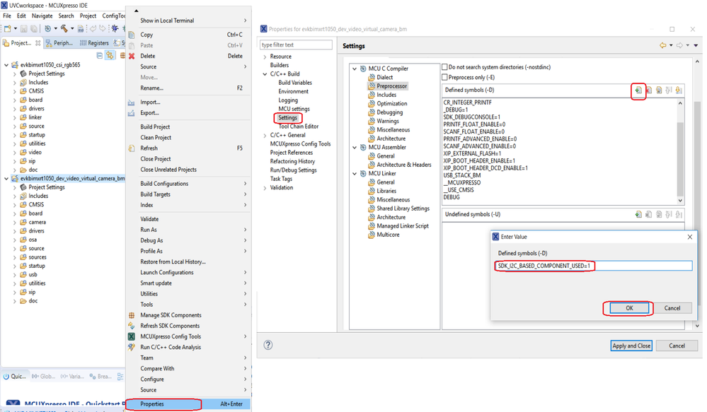

g) Right click on the Virtual_Camera project, and select "Properties". Then, select the "C/C++ Build -> Settings -> MCU C Compiler -> Preprocessor" menu, and click on the "+" button to add the following value: "SDK_I2C_BASED_COMPONENT_USED=1", and click on "OK" button.

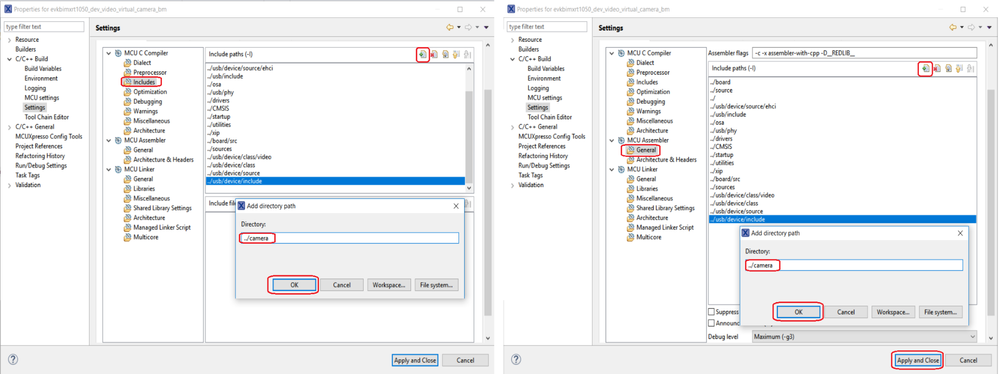

h) Now, move to the "Includes" menu of the same window, and click on the "+" button to add the following value: "../camera". Repeat the same procedure on "MCU Assembler -> General" menu, and then, click on "Apply and Close" button.

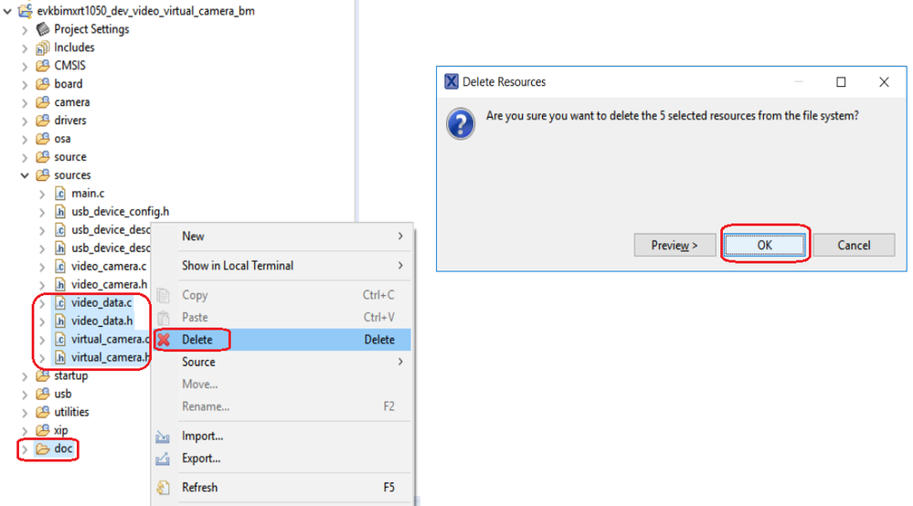

j) Select "video_data.h", "video_data.c", "virtual_camera.h" and "virtual_camera.c" files and "doc" folder, then right click and select "Delete". Click on "OK" button of the confirmation window to remove these resources from the Virtual_Camera project.

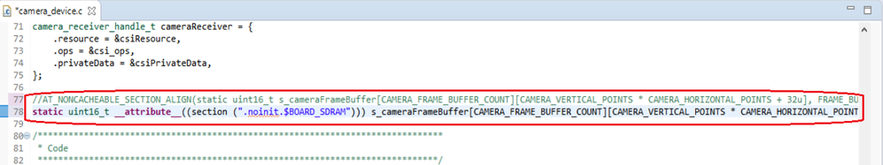

m) Refer to "camera_device.c" file from "camera" folder of Virtual_Camera project, and comment out the line "AT_NONCACHEABLE_SECTION_ALIGN(static uint16_t s_cameraFrameBuffer[CAMERA_FRAME_BUFFER_COUNT][CAMERA_VERTICAL_POINTS * CAMERA_HORIZONTAL_POINTS + 32u], FRAME_BUFFER_ALIGN);" and add the following line:
static uint16_t __attribute__((section (".noinit.$BOARD_SDRAM"))) s_cameraFrameBuffer[CAMERA_FRAME_BUFFER_COUNT][CAMERA_VERTICAL_POINTS * CAMERA_HORIZONTAL_POINTS + 32u] __attribute__ ((aligned (FRAME_BUFFER_ALIGN)));

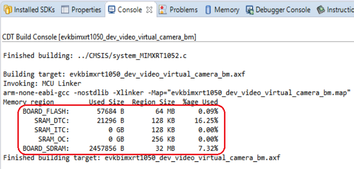

n) Compile and download the application into the EVKB-MIMXRT1050 board. The memory usage is shown below:

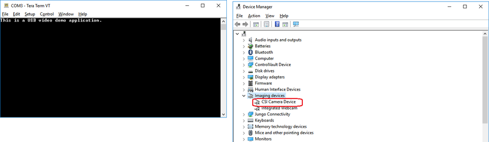

o) When running the application, if you also have the serial terminal connected, you should see the print message. Additionally, if connected to Windows OS, you could find it as "CSI Camera Device" under the "Imaging devices" category.

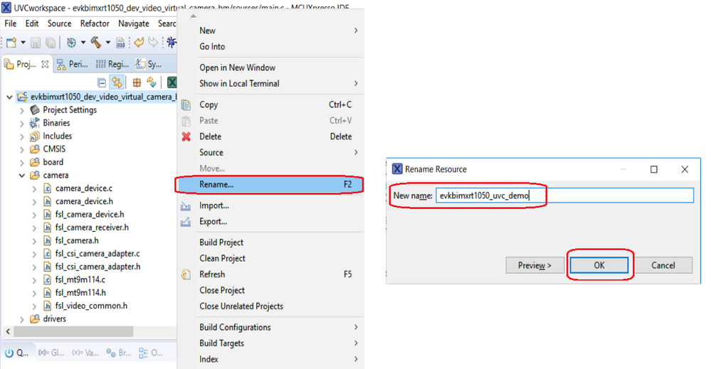

p) Optionally, you could rename the Virtual_Camera project to any other desired name, with rigth click on Project, and selecting "Rename" option, and finally, click on "OK" button.
