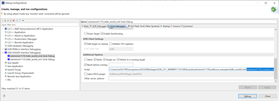

  2. Debug the CM7 project first. Then switch to CM4 project and also click the debug button. The CM4 project will not debug properly. So, we exit debug. With this step, the IDE created two deug configurations in RUN->Debug Configurations.
  3. Click the evkmimxrt1170_hello_world_cm4 JLink Debug, click JLink Debugger label, Add evkmimxrt1170_connect_cm4_cm4side.jlinkscript. Then unselect the “Attach to a running target” checkbox.
  1. Set a breakpoint at start of main() function of the CM4 project. This is because some time the IDE can’t suspend at start of main() when start debugging. A second breakpoint can be helpful. Take care to set the break point on BOARD_ConfigMPU() or below code. Don’t set break point on “gpio_pin_config_t led_config…”. Otherwise, debug will fail.
  2. Now we can start to debug CM7 project. Click the debug button in RUN-> evkmimxrt1170_hello_world_cm4 JLink Debug. This is because the IDE will enable “attach to a running target” automatically. We must disable it again.
  3. When CM7 debug circumstance is ready, switch to CM4 project and click “debug” button. Then resume the CM7 project. The CM4 project will start debugging and suspend at the breakpoint.
