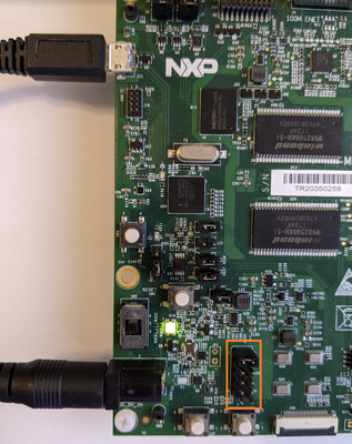

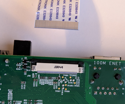

1) The camera connector is on the front of the board. Flip the black connector up so it's 90 degrees from its original position.
2) Then slide in the flat ribbon connector of the camera
3) Flip the black connector back down. It should keep the ribbon cable snug.

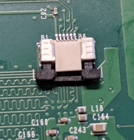

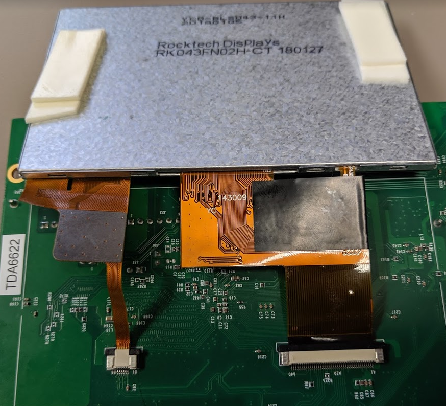

1) On the back of the board, slide the black connector for the LCD ribbon forward.
2) Then slide in the flat LCD ribbon cable underneath the black connector.
3) Slide the black connector back to its original position. The cable should be snug.

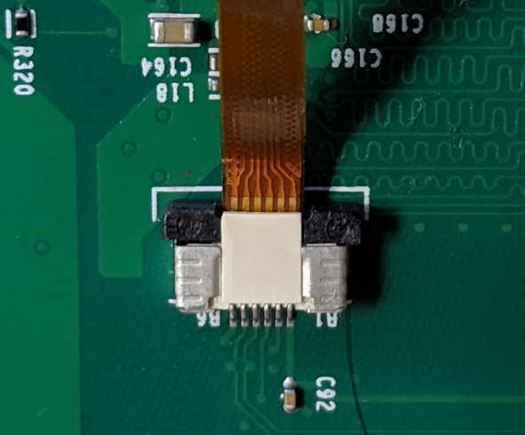

4) Do the same for the touch controller connector and slide the black connector forward
Then insert the cable between the black connector and the white top so that the cable is in the middle. It might take a few tries as its somewhat difficult. You could also use needle nose pliers to help guide in the cable but be careful about damaging the cable.
5) Then slide the black connector back to the original position. The cable should be snug.
6) It should look like the following when complete.

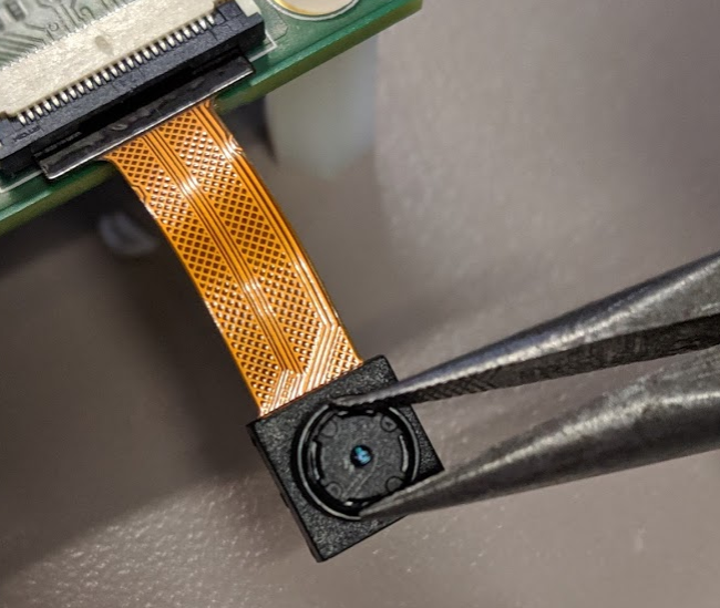

2) The camera will likely be out of focus the first time you use it. Adjust it by rotating the lens clockwise until the image is in focus. You can use your fingers or some needle nose pliers. It could take up to two rotations and it should turn easily. Also remove the plastic cover.

1) Once the LCD has been confirmed to work, you can use two layers of thick double sided foam tape to securely attach it to the board.

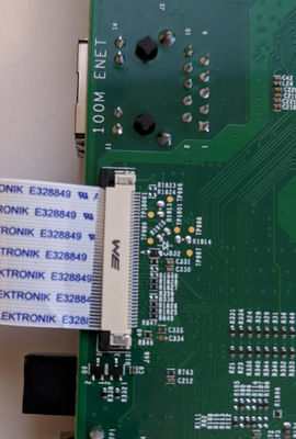

1) The camera connector is on the front of the board at J2. It connects by simply pressing the camera down onto the connector. It takes a bit of force but should not be too difficult.
i.MX RT1170-EVK LCD:
1) On the back of the board, slide the black connector (J40) for the LCD ribbon forward towards the edge of the board.
2) Then carefully slide in the flat LCD ribbon cable into the connector. The blue writing should be facing up like in the photo. It should go above the black part of the connector that you just slid out, and under the white part of the connector.
3) Slide the black plastic connector back to its original position. The cable should be snug if pulled. It should look like the following:
