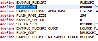

I am using the FlexSPI_not_polling transfer SDK example in our project, with modifications, to program an external chip.
when we are using the program page, all working well until it reaches the address: 0x800000.
when reaching this address, the write_enable method is failing with the error "kStatus_FLEXSPI_IpCommandSequenceError"
this is the code section that catch the error:
what is this error meaning and how can we resolve it?
everything works ok until we reach the address 0x800000. our chip is 32MB size

found the cause, need to define the flash size in KB:
0x8000 in kb = 32MB
