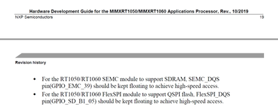

Also see this note from the hardware development guide
-Nick

It's very frustrating when things like this are hidden away in the documentation, with almost zero chance of being spotted! Grrrrrrr........
-Nick
