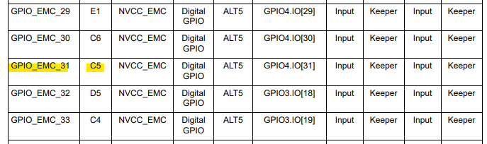

GPIO_EMC_31 this is SPI1 Pcs1 but my question is where this pin is available in imxrt1064 board, means which connector, which junction can you share location of this pin in board with (photo PLz).

Hi @mehulusdad,
As you can see in the RT1064 datasheet, GPIO_EMC_31 is routed to pin C5:
With respect to the EVK, this pin is already used for the SDRAM, so it couldn't be used for the SPI1 module.
Let me know if you have further inquiries about this topic.
