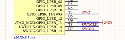

vladimirchernin
hi!
we connected JTAG_MUX_MOD  GPIO_LPSR_13 to Ground
and hardware eng check out all nxp pin requirements
SWD not stable i cannot access peripheral registries and gpios
i can burn flash erase flash and it ok
please help us to find out what the problem here?
thanks

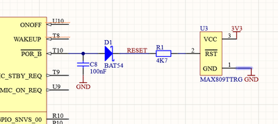

carstengroen
Senior Contributor II
I use this on my boards which works:
Carsten

vladimirchernin
hi!
thanks
29,729 Views

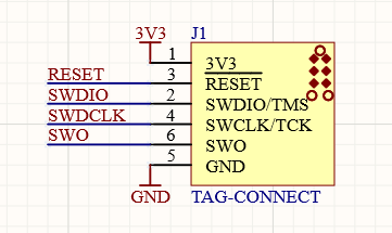

jeremyzhou
Thanks for your reply.
Firstly, the SWD interface is good after reviewing the above schematic.
Next, I'm not clear about the unstable behaves of SWD you mentioned, for instance, can't access peripheral registries and gpios, can you provide the testing steps in detail?
Last, I'd like to know what debug tool you used.
TIC

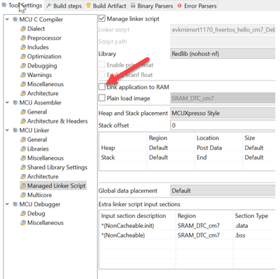

jeremyzhou
I'd like to suggest you do three more testings.
1) After opting the Link application to RAM, then give a debug.
2) Use the tool to program the image to QSPI, then check the board whether can boot up successfully.
3) Please use other IDEs such as IAR, Keil to do debug testing.
TIC

vladimirchernin
I checked RAM image its works.
I also check QSPI flash burn works ok.
The problem here is Rev B of the CPU and workaround scripts NXP didnt work
i suppose its still in debug loop
Did you fix it in CPU rev C ? please can you ask guys in R&D ?
pls see  log below reste script reset cannot reset cpu
Vladimir

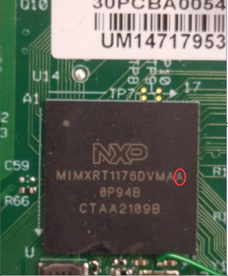

vladimirchernin
Hi!
First we cannot debug from RAM and we dont have another IDE to work with why we need it NXP has IDE
I have explained and you see my problem is CPU rev.b and you see the log
its not  working
Please ask people inside NXP regarding the problem
see the photo below
29,428 Views
jeremyzhou
Actually, your chip is still an A version, not the Rev B.
In my opinion, the issue is related to the hardware and I'd like to whether the issue happens on all custom boards.
TIC
