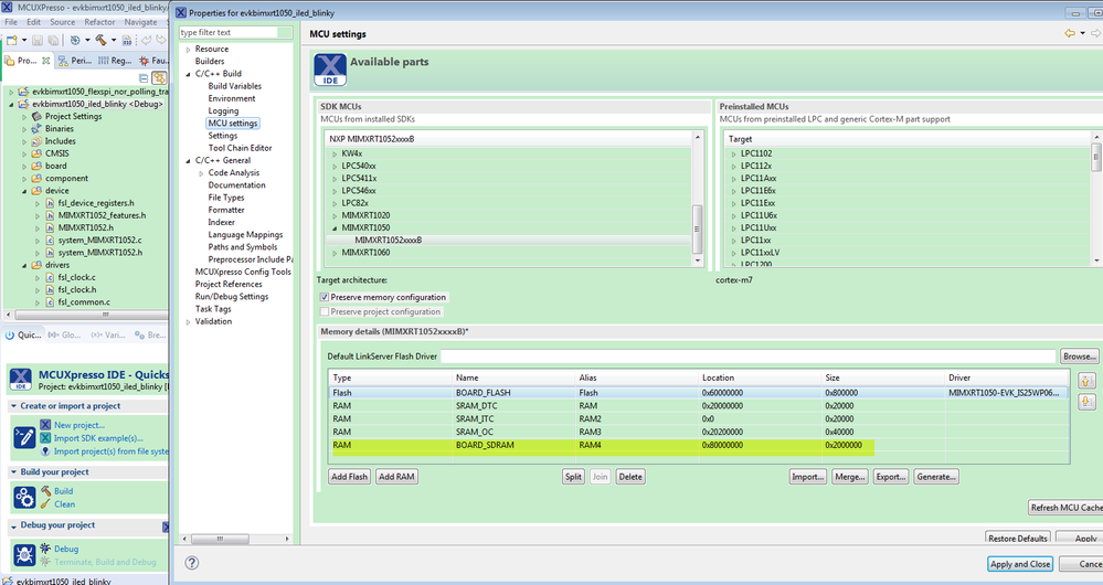

       Do you want to run the code from the external qspi flash, but define some data in the SDRAM?
       Do you define the SDRAM sector range in the MCU Setting?

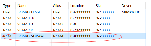

先回答你的问题:1,目前跑在hyper flash xip下(IMXRT1050-EVKB),想把text部分和部分数据放在SDRAM里面跑。
                             2,使用的ld脚本为:sdk example导入的基础上修改。
                             4,如果把上述帖子中的:> BOARD_SDRAM_UPPER AT>BOARD_FLASH  改成 :“SRAM_ITC AT>BOARD_FLASH”,运行正常。
                             5,memory:
 MEMORY
/* Define each memory region */
BOARD_FLASH (rx) : ORIGIN = 0x60000000, LENGTH = 0x4000000 /* 64M bytes (alias Flash) */
BOARD_SDRAM_UPPER (rwx) : ORIGIN = 0x81E00000, LENGTH = 0x00200000 /* 2M bytes (alias RAM) */
BOARD_SDRAM_LOWER (rwx) : ORIGIN = 0x80000000, LENGTH = 0x01E00000 /* 30M bytes (alias RAM) */
SRAM_ITC (rwx) : ORIGIN = 0x0, LENGTH = 0x20000 /* 128K bytes (alias RAM2) */
SRAM_DTC (rwx) : ORIGIN = 0x20000000, LENGTH = 0x20000 /* 128K bytes (alias RAM3) */
SRAM_OC (rwx) : ORIGIN = 0x20200000, LENGTH = 0x40000 /* 256K bytes (alias RAM4) */
