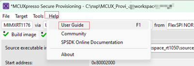

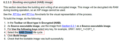

Hi @mjpovi ,
HAB Disable/Enable is related to Life Cycle of the Processor.
Please check User Guide, Help -> User Guider.
In this MCUXpresso Secure Provisioning Tool User Guide pdf, This document describes the relationship between the Boot type and  HAB opened/closed.
The following diagram illustrates one of these correspondences.
Wish it helps you.
