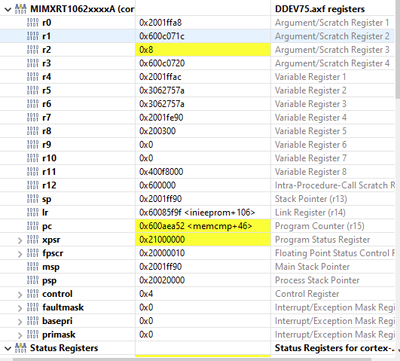

We experience a problem with a call to the memcmp function.
We are using MCUXpresso 11.4.1 and the Redlib library.

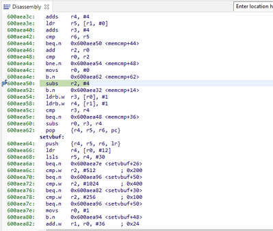

Under certain circumstances, the memcmp function returns the wrong result. We debugged by looking at the disassembly, and experienced unexpected behaviour there.
It seems that in the failing cases, the subs r2, #4 instruction is not executed.

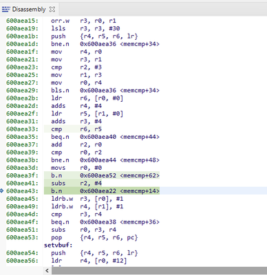

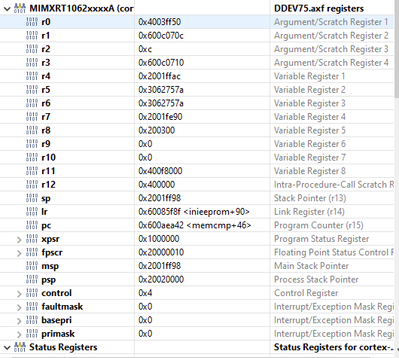

Following are screenshots from the debug session, first for the successful case, and then for the failing case.
Successful case
Situation before the SUBS r2, #4
Situation after SUBS r2, #4
This is as expected, r2 has been decremented by 4.

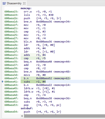

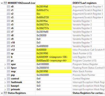

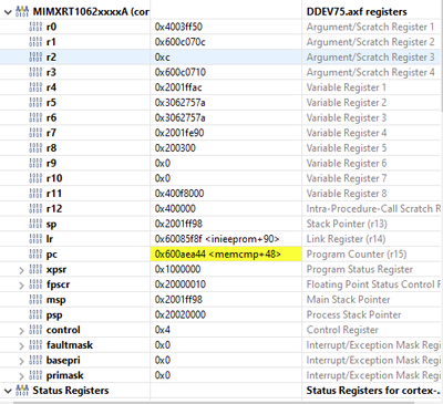

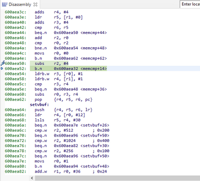

Failing case
This is not expected. r2 stays 0xC, and this seems to be the reason why the memcmp fails.
What could lead to such a failure?

In my opinion, to avoid the cache data coherency problem, I'd like to suggest assigning a non-cacheable buffer for the store variables or arrays that will be used as input parameters in the memcmp function, it.
And please refer to the application note to do it.

Unfortunately, the problem only happens under very specific circumstances and in our full project.
The code was working, until we changed some things in other places of the project. Then suddenly it failed.
This happened to us before, it seems like it could be a problem with pipelining/cache or maybe it is dependent on what address the variables are allocated.
