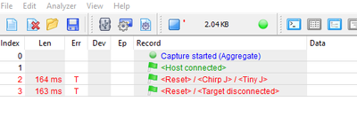

When run lwip_dhcp_usb_bm/freertos examples on RT1050, it cannot detect the mobilephone device when connect it with Huawei Mate40 Pro using UGREEN OTG usb cable. (https://item.jd.com/27995995406.html).
Note: have tried it using SSK OTG usb cable, and it works well. But we need use UGREEN OTG usb cable in our case.
Reproduce:
  1. Prepare one RT1050-EVKB boards, download the sdk v2.10.0 package from the https://mcuxpresso.nxp.com/.
  2. Unzip the package and build the lwip_dhcp_usb_bm  (iar flexspi_nor_release) project, download it and start to run.
  3. Connect Mate40 Pro mobile phone to the board usb port with UGREEN OTG usb cable, it cannot detect the mobile phone(no attach log printed). The log is shown in below.

I wonder if have any update... I can't get this same sample code to work either on RT1020 both freertos/bm versions regardless of several known working OTG USB cables. On booting up, debug console displays only "Host init."  and USB analyzer shows zero activity.

I have mu doubts this is a compatibility issue since using other cables works, I would suggest to try using an oscilloscope or USB analyzer to check to signal and which section of the enumeration process is not done correctly.
