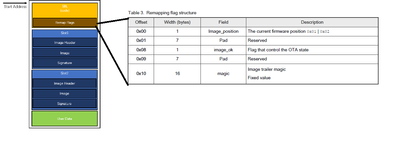

What a mess….For imxrt1170 mcus , remap mode is the way to go because swap boot type uses too much flash erasing and writing unnecessary.
Some chips of i.MXRT series have the feature of remap. The addition of Remap mode is based on this feature. To enable this
feature, set up three registers, the start address, end address, and offset address.
Compared with the Swap mode, this function
greatly reduces the number of flash erasing and writing, prolongs the service life, and shortens the time for FOTA greatly.
But when you use remapping, you should use remap trailer instead of two swap image trailers. When I inspect the SDK project, there is no remap trailer also still trying to use swap trailers…..

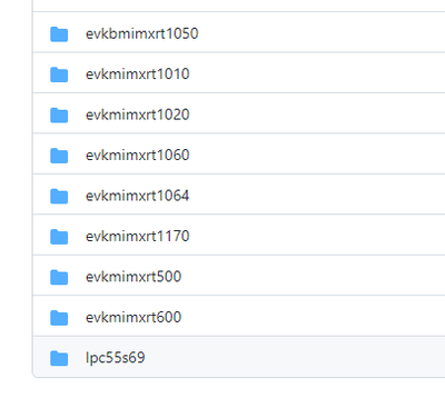

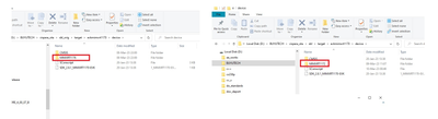

Help needed...the solution i posted above works for rt1176 based evk. But for our custom board which is based on rt1172, i couldnt make it happen.
The problem is SBL is for rt1176...https://github.com/nxp-mcuxpresso/sbl   because evk is based on it. What to do for SBL for RT1172?
I have changed MIMXRT1776 directory from one found internet with MIMXRT1172.I have modified some directories and Sconscript files to point them, but they didnt work. Is there a SBL for rt1172?
