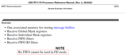

I would like to implement a gateway from CAN-FD to ethernet in the IMXRT1176. The gateway should forward all can-message-id's, so obviously I cannot assign one ID to one mailbox.
From the documents I see that a RX-Fifo is not supported when CAN-FD is activated. This means that for CAN-FD operation I need to use mailboxes. Correct?
What is the correct concept to receive ANY CAN-FD frames (without changing the receive order of the messages in the firmware)?

Question1: From the documents I see that a RX-Fifo is not supported when CAN-FD is activated. This means that for CAN-FD operation I need to use mailboxes. Correct?
Answer1: Yes,   in MIMXRT1170RM described that "Rx FIFO cannot be used in FD mode", but you can use mailboxes.

Question5: It would be much simpler to have a built-in fifo that supports CAN-FD...
Answer5:   I am sorry about that, and MIMXRT1170RM tell us that CANFD can not use RX FIFO.
