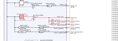

We are working with custom boards based on the RT1170, and using the MCU Xpresso IDE. To pass the EMI/EMC test, we need to drive the SEMC clock root through any of the main clocks that support spread spectrum. However, according to the datasheet, SEMC only supports the following main clocks which is having spread spectrum
- SEMC_ClockRoot_MuxSysPll1Div5
- SEMC_ClockRoot_MuxSysPll2Out
- SEMC_ClockRoot_MuxSysPll2Pfd1

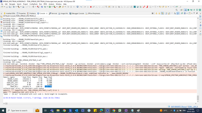

Except for these clocks, all the others do not support spread spectrum. We attempted to work with PLL2, but encountered the following error
 I am providing a forum link that discusses a similar issue.
Trying to enable SSC on RT1170 EVK with MCUXpresso. Ref: AN12879 Steps: 1. Base project: SDK Example evkmimxrt1170_semc_cm7 2. Using IDE to config SSC  3. Boot failed 4. Sometimes can boot normally (~ 1/50) Any step I missed? Regards Seen
community.nxp.com

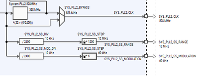

The alternative option is to drive it through PLL1. According to AN12879, for instance, we are attempting to set 12MHz as the range and 60Hz as the step. However, configuring this through the configtools has not been successful. There are various constraints to consider, such as the input being 24MHz, the output being 1GHz, etc. Also, setting the range and step has been unsuccessful.
Kindly address this issue and provide a reply as soon as possible. Thank you.

But my code is working on SDRAM, and when i am trying to put the fsl_clock.c into the SRAM_OC1, but the fsl_clock.o is of 3.3MB, i don't know why it is this much big, and it is not fit in that region,

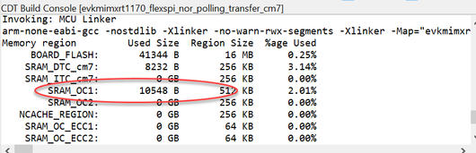

The demo would not take so many memory resource, did you change it according to your custom board? It just takes about 10k here for SRAM_OC1.
Is it possible to share your code for a review?
