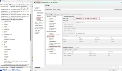

I have one custom bootloader located at 0x30000000 till 0x30080000. I compiled it with these addresses.
After that, my main app starts from 0x30800000 till 0x31000000. I compiled my main app with these addresses.
When I compiled my main app:

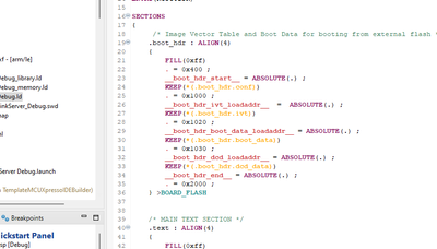

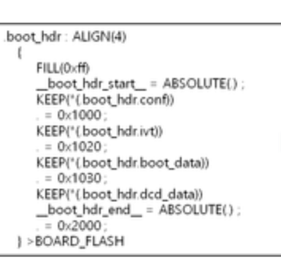

Automatically generated project_name.debug.ld file in Debug folder does not add below header info to linker file. However if I start my main app with 0x30000000 address, that debug.ld file adds below lines as it should be.
Since I have to use my bootloader, I need to compile my main app with offset  address I stated above. Otherwise, if it does not have below lines, my main app does not work.
So, how can I keep below lines in debug.ld file when I compile my app with offset relative to 0x30000000 address? I do not want below lines to be deleted automatically.

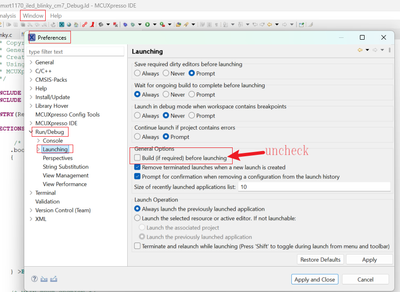

1: The follows resources will be refreshed after the project is built
2: Window->Preferences->Run/Debug->Launching-> Uncheck it Build(if required) before launching
Wish it helps you.

Hello @mayliu1,
I did your directives. But it does not help me. Problem still exists.

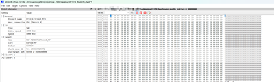

Here is the SS.

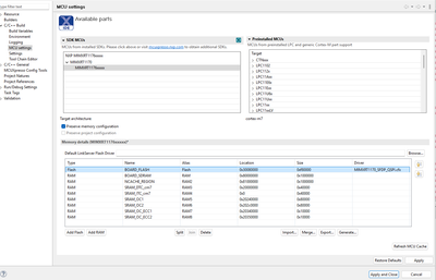

My memory address is below

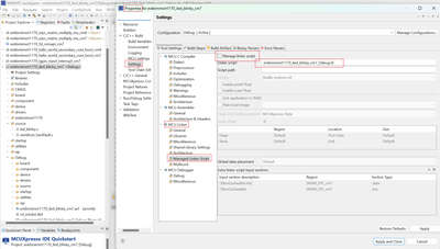

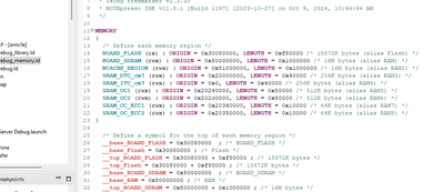

As I mentioned, when ı give offset address to the origin 0x30000000, IDE deletes the required parts in debug.ld file in Debug Folder as below automatically.
I need the above one in automatic linker file.
My IDE is MCUXpresso v11.8.1

Please try to set as I show.

burhanhagi
Contributor V
Hi @mayliu1 ,
I have used it in a way you suggested up to now. That is why I am aware of that for a long time.
However. I have to make everything as automatized with some script files. I need a permanent solution, not manual intervention. Because I will use it in a mass production.
That is why it does not solve my problem.

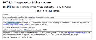

section "BOARD_FLASH" is used for boot ROM, It is related to the address 0x30000000 the address,  For example ,IVT address is Absolute address.
I think you can refer to MIMXRT1170RM 10.1 Chip-specific Boot Information.
https://www.nxp.com/webapp/Download?colCode=IMXRT1170RM
Your bootloader located at 0x30000000 till 0x30080000. It must need section "BOARD_FLASH".
Your App starts from 0x30800000 till 0x31000000, I think this APP project do not need  section "BOARD_FLASH", because if your bootloader start successfully,  do some of your logical processing , then will jump to the app 0x30800000.

Hi @burhanhagi .
Thank you for your updated information,  I would  like to provide service for you.
I don't think your problem is to set up the MCUXPresso IDE , but to solve the problem of why your APP  don't work.
Answer 1:
If you still want setting MCUXPresso IDE to not change xx__Debug.ld, I have shown to  you.
mayliu1_0-1728699171325.png.

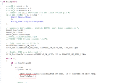

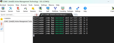

Answer 2: I use MIMXRT1170-EVKB board,  and program bootloader and  app project.
The Bootloader address and APP address setting is exactly the same as those you set.
And APP Debug.ld  do not have section "BOARD_FLASH".
I can jump to the APP successfully. Please check your Bootloader and app code.

No need full project codes anymore. The part you shared shows the useful part.
Actually, I had ported already existing codes from ST platform to NXP platform. In ST platforms, I did the same as you shared above when I want to jump APP. However in NXP, the situation has a little bit changed. I reviewed several examples as well as mcuboot_opensource specially example in SDK. It shows there when trying to jump your APP:
0x2000 address offset relative to the first loaded flash base address. So, in our case, 0x30080000 + 0x2000 address is my jump address. At first I surprised because I thought I must have added +4 for ISR Reset Handler. Also I had questioned why 0x2000 offset required? Because this part is only being questioned by on-chip Boot Rom firmware at initial power-up. Anyway, when my codes are running perfect, I do not make any additional steps or consideration. Just admit it was true and OK.
My jump address and yours is different. That is why you do not need the first required boot header info. But I wonder why mcuboot_opensource SDK example explains different than you? Is it possible to review that example? I really wonder where I am missing there.

It worked. No need boot header section in linker debug.ld file of APP anymore.

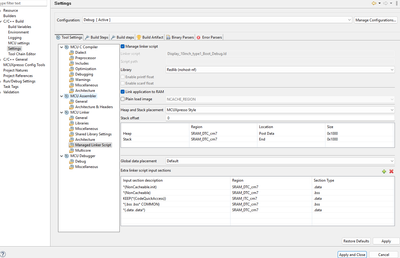

2,713 Views
burhanhagi
Contributor V
Hi @KAVIN_M ,
It is not possible to share the project. However, I can share the settings as below;
I have 2 firmware running. First when power enters into the PCB, below settings bootloader is running first;
As you see above, first bootloader is copying itself to the external SDRAM.
When bootloader finishes its job, it runs the main firmware as below;
Lastly, the main firmware begins to execute. Here is its settings;

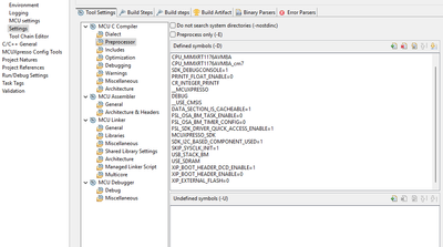

As you know; linker is automatically created by IDE according to the above settings. So sharing it is the same with linker files.
By the way; in boot firmware the preprocessor flags is as below;
However, in main firmware those flags is as below;
Hope it helps.

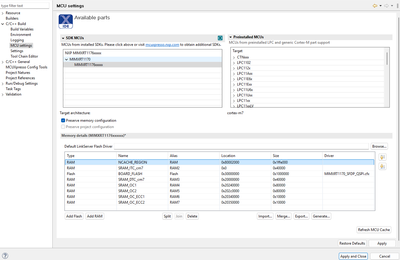

What is did so far for BL start adder 0x30000000, only size is modified using the MCU setting in IDE.
In Application project, using MCU Setting offset the board flash start address w.r.t BL size(len).
But the code is either getting into Active fault sometimes or not reaching the desired location.
Once the linker is modified (address offset) the project is not working properly. Is it related to the QSPI flash driver or anything else.
