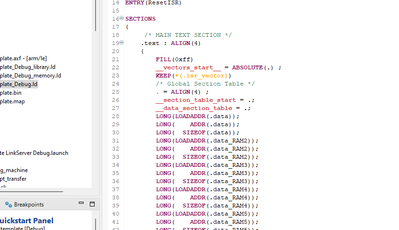

I have one custom bootloader located at 0x30000000 till 0x30080000. I compiled it with these addresses.
After that, my main app starts from 0x30800000 till 0x31000000. I compiled my main app with these addresses.
When I compiled my main app:
Automatically generated project_name.debug.ld file in Debug folder does not add below header info to linker file. However if I start my main app with 0x30000000 address, that debug.ld file adds below lines as it should be.
Since I have to use my bootloader, I need to compile my main app with offset  address I stated above. Otherwise, if it does not have below lines, my main app does not work.
So, how can I keep below lines in debug.ld file when I compile my app with offset relative to 0x30000000 address? I do not want below lines to be deleted automatically.

2,584 Views
burhanhagi
Hello @mayliu1,
I did your directives. But it does not help me. Problem still exists.
Here is the SS.
My memory address is below
As I mentioned, when ı give offset address to the origin 0x30000000, IDE deletes the required parts in debug.ld file in Debug Folder as below automatically.
I need the above one in automatic linker file.
My IDE is MCUXpresso v11.8.1

2,554 Views
burhanhagi
Hi @mayliu1 ,
I have used it in a way you suggested up to now. That is why I am aware of that for a long time.
However. I have to make everything as automatized with some script files. I need a permanent solution, not manual intervention. Because I will use it in a mass production.
That is why it does not solve my problem.

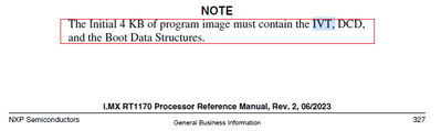

2,517 Views
mayliu1
Hi @burhanhagi ,
I'm sorry for the incorrect understanding of your question before.
section "BOARD_FLASH" is used for boot ROM, It is related to the address 0x30000000 the address,  For example ,IVT address is Absolute address.
I think you can refer to MIMXRT1170RM 10.1 Chip-specific Boot Information.
https://www.nxp.com/webapp/Download?colCode=IMXRT1170RM
Your bootloader located at 0x30000000 till 0x30080000. It must need section "BOARD_FLASH".
Your App starts from 0x30800000 till 0x31000000, I think this APP project do not need  section "BOARD_FLASH", because if your bootloader start successfully,  do some of your logical processing , then will jump to the app 0x30800000.
Wish it helps you.
Best Regards
mayliu
2,504 Views
burhanhagi
@mayliu1 , I faced this kind of problem a while ago. However, as you see in the link, The method suggested there helped me. Now the same debug.ld file causes me to prevent from automating of process. I think there must be an easy method in the below link.
https://community.nxp.com/t5/i-MX-RT-Crossover-MCUs/imxrt1176-freertos-linkerscript-file-problem/m-p...
2,509 Views
burhanhagi
Hi @mayliu1, As I stated before, my app works well. However, without those lines in debug.ld file, my app does not work and enters exception. So I need those lines.
I tried without those lines, even today again, but it not work. So please help me a way how to keep those lines there when I compile my app.
I think there should be a simple method or simple setting in IDE to keep it there. Thanks

2,416 Views
burhanhagi
Hi @mayliu1 ,
How did you load your bootloader code and your main app code to flash? Are you loading them with debugger seperately?
Also when only bootloader is running, are you able to write your main app code to the same flash with yout bootloader? If yes, what is your bootloader code xip_boot_header_enable, xip_external_flash and xip_dcd_header_enable preprocessor flags value? Also what is those flag values in your main app? Which address are you jumping when switch bootloader to main app? After compiled your bootloader code, which address do you start to load your code to Flash? Also after compiled your main app code, which address do you start to load your code to this same Flash?
Can you please upload your bootloader and app source codes as project? Maybe I can see the difference much better if I see the each code and details.
Thanks a lot.

2,378 Views
burhanhagi
Hi @mayliu1
No need full project codes anymore. The part you shared shows the useful part.
Actually, I had ported already existing codes from ST platform to NXP platform. In ST platforms, I did the same as you shared above when I want to jump APP. However in NXP, the situation has a little bit changed. I reviewed several examples as well as mcuboot_opensource specially example in SDK. It shows there when trying to jump your APP:
0x2000 address offset relative to the first loaded flash base address. So, in our case, 0x30080000 + 0x2000 address is my jump address. At first I surprised because I thought I must have added +4 for ISR Reset Handler. Also I had questioned why 0x2000 offset required? Because this part is only being questioned by on-chip Boot Rom firmware at initial power-up. Anyway, when my codes are running perfect, I do not make any additional steps or consideration. Just admit it was true and OK.
My jump address and yours is different. That is why you do not need the first required boot header info. But I wonder why mcuboot_opensource SDK example explains different than you? Is it possible to review that example? I really wonder where I am missing there.
Thank you very much for your valuable assistance. I will try it on Monday and share the results with you.

2,291 Views
burhanhagi
Hi @mayliu1 ,
Thank you very much for your valuable helps and guide.
It worked. No need boot header section in linker debug.ld file of APP anymore.
Have a nice day. Best Regards
Burhan
