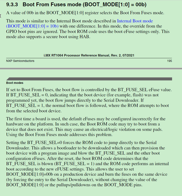

Hi, above diagram is from imxrt1064 RM page 200, and in page 198, there says:
"The boot ROM uses the state of the BOOT_MODE and eFUSEs to determine the boot
device. For development purposes, the eFUSEs used to determine the boot device may be
overridden using the GPIO pin inputs."
1. Can I know what are the Factory default settings? will GPIO has higher priority than eFUSEs by default?
2. How GPIO can overridden eFUSEs? and what are the settings to be done to skip the GPIOs checks?
3. What does the "and/or" exactly mean in the diagram?
=>Answer: it is determined by your configuration.
If you don't do the fuse burn, then it will determined by the GPIO pin feature, this is the default situation.
As fuse burn can't be back, just can be from 0 to 1.
fuse default is all 0.
=>Answer: Not overridden eFuse, you can consider, if you burn the fuse, select boot from the fuse, then it will use the fuse configuration.
If you don't, then it will use GPIO.
Check this RM content, you will be more clear:

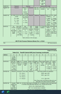

=>Answer:  some CFG can use the fuse bit even when you use the GPIO as the BOOT_CFG.
Eg, these fuse:
Also can be used with GPIO boot method.
Just the CFG fuse + BT_FUSE_SEL=1, and BOOT_MODE =00, will use the boot from fuse, and use fuse CFG related data.
Wish it helps you!
