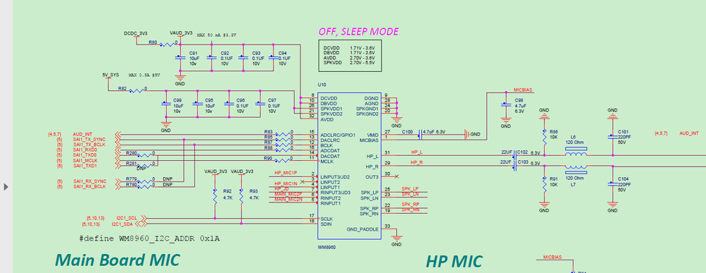

image.png  HP_L and HP_R?

I plugged a TRRS cable into the headphone out jack and ran the two output channels to the AP.

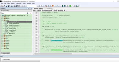

I traced through the code and compared it to the WM8960 data sheet.  The headphone volume register can be set for up to +6dB gain, which is 127 (bits 0-7 all 1).  But the driver function limits this value to 100.
If I use a lower level call to get around that assert, then I can get 300mV RMS out of the headphone jack, which is still much lower than 1V RMS per the data sheet.

   1. About the volume
In fact, it is the percent, if 100, it will get the max value:
#define WM8960_HEADPHONE_MAX_VOLUME_vALUE 0x7FU
#define WM8960_HEADPHONE_MIN_VOLUME_vALUE 0x30U
mappedVolume = (volume * (WM8960_HEADPHONE_MAX_VOLUME_vALUE - WM8960_HEADPHONE_MIN_VOLUME_vALUE)) / 100U +
WM8960_HEADPHONE_MIN_VOLUME_vALUE;
retVal = WM8960_SetVolume((wm8960_handle_t *)((uint32_t)(((codec_handle_t *)handle)->codecDevHandle)),
kWM8960_ModuleHP, mappedVolume);
So, this part, even you give 100, the real value should be mappedVolume=(100*(127-48)/100 + 48)=127
It is the max data.

Hi, I didn't notice that code, maybe I have an older version.  And my copy had some ASSERTS to check the input variables.  Are you sure you're looking at the RT1060 code?  But I called WM8960_SetVolume directly so it had the same effect.  And I checked all the other registers, everything else seems to be set to maximum level, but please double check.

  You mentioned RT1010 in the previous post, so I am checking:
SDK_2.9.1_EVK-MIMXRT1010\boards\evkmimxrt1010\driver_examples\sai\edma_transfer
You can check it again, SDK2.9.1

   Thanks for your updated information, so now, even you set the volume to the max 127, you still can't get the codec mentioned RMS 1V, right?
Your real test point is J11_2 and J11_3, the wave between these to pins, didn't get the related data?
Do you check the HP_L to ground, whether it is 1V?
This is mainly the codec question, I think you also can check with the codec company how to get the datasheet's mentioned max data.
Anyway, after you confirm the detail test point, I will help you to check with internal expert. But I don't have your first post picture tool, I just have the oscilloscope, so I need to confirm your real test point at first.

Yes those test points are connected to the jack, so same potential.
