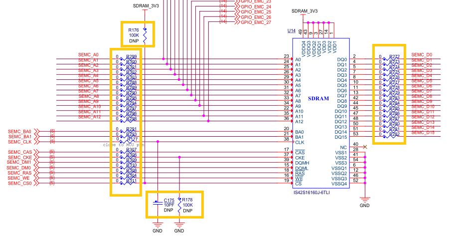

My design use a imxrt1021 in LQFP144 package and a 32MB SDRAM directly connected routed in 2-layer board with good GND plane but with great distance for the plane (due to tickness of 2-layer PCB). This produce impedance mismatch for DQn/Dn/CKx/etc.
The design files is in:
GitHub - martinribelotta/imxrt1020-module: iMX RT 1020 CPU module
In the hardware design manual it advice to put resistors on the pins of data and directions to avoid the reflection of the signals due to impedance mismatching. The dimensions of recommended tracks/vias in the PCB design rules is apparently specified for a 4-layer PCB with standard stackup, not for 2-layer.
But... when I see the refernece design (MIMXRT1020-EVK design files) the series resistors is 0ohm (sheet 12 of the document "SPF-29856_A3.pdf" inner MIMXRT1020-EVK-Design-Files.zip file)
The gerbers in the design package show a bad GND plane and many lines crossing. This is good practice?

I have the following doubts:
  • Is reliable the routing of 1020 EVK?
  • The R0 ohm in serie with data/address/control/clock lines is necesary?
  • The absence of good ground plane is problematic?
  • In any case... The problems may mitigate dropping down the CLK frecuency of SDRAM?

igorpadykov
Hi Martin
recommended to follow guidelines provided in
Hardware Development Guide for the MIMXRT1050/MIMXRT1060 Processor
https://www.nxp.com/docs/en/user-guide/MIMXRT105060HDUG.pdf
Reference board was designed when not all documentation was prepared so
it may differ from recommendations in Hardware Development Guide.
yes

martinribelotta
Maybe you refer of this:
https://www.nxp.com/docs/en/nxp/user-guides/MIMXRT1020HDUG.pdf
For mimxrt1020 two layer board route? (section 8: Two (p)layer board design)
Ideally, all this problems have solution in a 4layer standard PCB with basic high speed stackup but the cost increase and the imxrt102x family is designed for low cost design (for a 4 layer board is preferable the imxrt1050/60)
In the section 7.1 (stackup) I cannot calculate the same impedance than the document with standard FR4:
The trace impedance with this dimensions and 56mils of stackup space is 150 ohm in standard FR4 with ER 4.3 if my calculus is right.
I accomplished with all rules in section 7.5 of the same document.
In section 8.4 this recommend said:
Also, it’s found that it needs to lower to SDRAM drive strength to DSR level 3 in software to balance 133MHz R/W speed and board EMC performance.
This paragraph reference to DSR level 3 strength on the SDRAM drivers. I not localize any reference in RefMan:
https://www.nxp.com/docs/en/reference-manual/IMXRT1020RM.pdf
Of this register. Some additional info?

martinribelotta
Perfect. I found the rigth way to match impedances on my design.
(from IMXRT1020RM.pdf)
