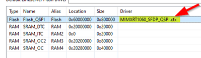

We have design our board using an imxRT1061. When we link application to RAM we are able to launch and debug our program as expected with LPC-Link 2.
We have define FLASH section and select the correct FLASH driver.
We have define preprocessor directive for XIP
On the boot config pin we have select the following config

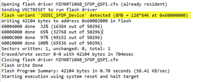

When debuging, flash seems to be detected and programmed
Debuger never stop at Main(), and code is not running. when i paused the debuger code seems to be in RAM range at address 0x200xxxxxx.

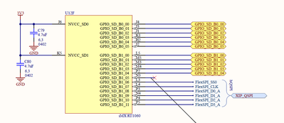

hi @jeremyzhou,
here is some detail on the schematic.
flash part
MCU part:

I have programmed a my blinky test software with the MCU boot utility without error.
My led are flashing the same way than in RAM debug. when i reset or power again my board my LED are flashing again.
So i'm assuming my flash wiring is correct. but the same program can be debug when linked to RAM and i can't when i try to link it to flash

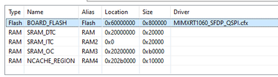

To enable debugging this QSPI, an appropriate flash driver is a precondition, so I'd like to know the kind of firmware of LPC-Link2 you used, Jlink or CMSIS-DAP?
TIC
6,823件の閲覧回数
guillaume_g
hi @jeremyzhou ,
Your understanding is correct.
I'm using LPC-LINK2 with CMSIS-DAP driver, from my understanding the flash driver is configured with the flash section, in my case the SFDP QSPI driver.
To use SFDP parameter i burn the fuse  Boot CFG 0 to 1 to auto probe parameters,is my understanding correct?

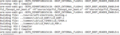

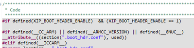

I am trying to make a quick and dirty test, copying the file in the XIP directory of the SDK project into my own project.
i set the preprocessor directive "XIP_BOOT_HEADER_ENABLE=1" to add flash configuration data in the image.
but when i compiled the code in the editor MCU expresso said me that defined is not set
And when i look into the console, i have two files that are compiled with the defined set to 0
The two file are evkmimxrt1060_flexspi_nor_config.c and fsl_flexspi_nor_boot.c.
The file added from the SDK project.
I don't see where this defined is cleared.
Any clue?

jay_heng
You set XIP_BOOT_HEADER_ENABLE=0 in preprocessor directive to test BootROM auto-probe feature, right?
I have one detailed blog on this topic (It is in chinese)
https://www.cnblogs.com/henjay724/p/14449341.html
Can the image boot properly after power-on reset then?
6,847件の閲覧回数
guillaume_g
Hi Jay,
the auto probe feature is enable. ihave set the XIP_BOOT_HEADER_ENABLE bit to 0 because in a App note or a forum topic i 'have seen that we should clear it. But it was set to 1 before and i have the same result.
