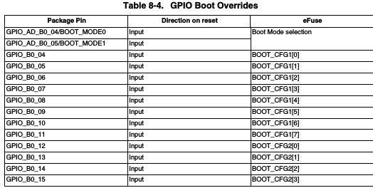

Hello. I'm starting a development of imx-rt1021 board using as reference the MIMXRT1020HDUG (Hardware Development Guide), the reference manual (IMXRT1020RM)
In IMXRT1020RM, page 292, section 8.4.2 the table 8-4 specifies this pin bootstrap configuration:

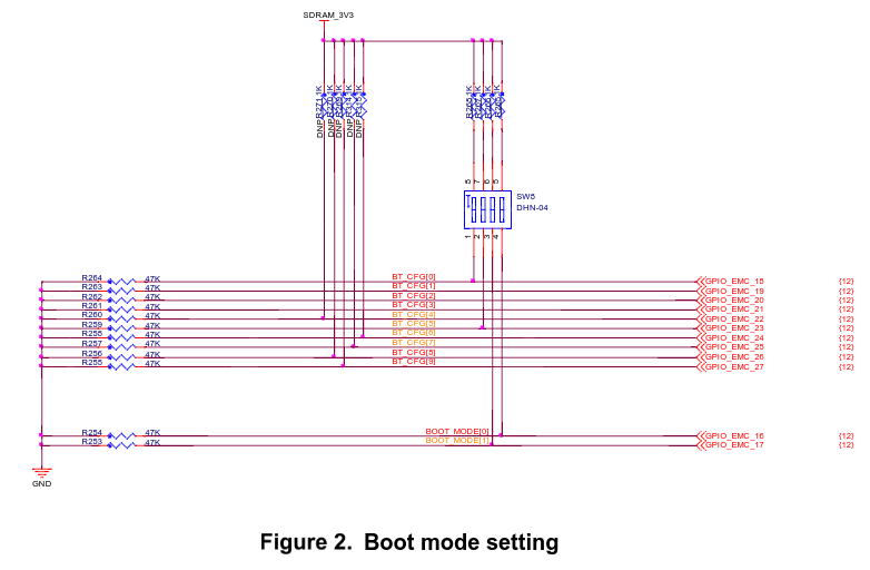

This is consistent with page 8 of hardware reference manual (MIMXRT1020HDUG), Figure 2:
And the MIMXRT1020-EVK implementation (Sheet 14)
In concret. The BOOT[1:0] is from GPIO_EMC[17:16] or GPIO_AD_B0_[04:03]?

CarlosCasillas
Hi Martin,
The internal revision concluded that Table 8-4 of the Reference Manual is a mistake. Thanks a lot for your feedback reporting this issue.

CarlosCasillas
Hi Martin,
According with the table of i.MX RT1020 Reference Manual section 4.1.1 “Muxing Options”, the boot select pins are also mapped to GPIO_EMC pins, so it seems to be a typo on Table 8-4.
I have reported this issue, thanks a lot for your feedback. I will post an additional reply when confirming the correct information.
