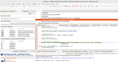

I tried to modify the SDK example by simply replacing kFLEXSPI_PortA1 with kFLEXSPI_PortB1.
When I then rerun the SDK example, it faults (IBUSERR) on configuring the eDMA.
Hope you can help me out in this quest

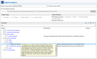

Base on what you said, and as following up from your previous thread, as your secondary flash hardware from FlexSPI B is now working, you may follow the example for RT1024 (flexspi_nor_edma_transfer) to write, erase and read from that external flash as shown here:
Then, if you are using MCUXpresso and you program your RT1024 with the LPC-Link2 or USB, via CMSIS-DAP (that it is the default debug method), you will be able to flash on the internal memory and debug to see registers, values, etc.
