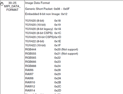

I'm trying to develop a UVC device with RT1176 processor. While developing we saw that the CSI was using a frame buffer double the size than required. i.e, frame_height*frame_width*4 instead of the required 2. This was to use 24bit Parallel bus. We can't afford frame buffers of that size in our design. So we reduced the bus width to 16 bit and bits per pixel to 2 in CSI receiver's setting (the example source we are using is evkmimxrt1170_csi_mipi_yuv_cm7).
Bits per pixel of camera receiverBits per pixel of camera receiverChanging Databus widthChanging Databus width
When I observe the data, The frames are not proper and UV component is missing.
The one in left is how the actual data looks and the one in right is how we receive in RT1170.
Actual data of a Black frameActual data of a Black frame     Data received in RT1170Data received in RT1170
 I tried changing the data format as well but no improvement. I'm not sure what we are missing here. Can someone pls shed some light?
Setting MIPI data formatSetting MIPI data format

Thanks for the effort. I'm stuck at the same situation. The PXP is not the problem here, if you can check the data(easier with memory monitor in IDE) before giving it to the PXP we can see that the UV component is missing. My assumption is we are setting the CSI receiver in 16 bit and MIPI-CSI2 is giving out data in 24 bit. My end application should send YUV422 over UVC so the RGB suggestion won't work out for me.
You can add the following line of code in static status_t OV5640_SetPixelFormat(camera_device_handle_t *handle, video_pixel_format_t pixelFormat) in fsl_ov5640.c to generate a static black frame and compare the data after our new setting and the default.
OV5640_CHECK_RET(OV5640_WriteReg(handle, 0x503D, 0x83));
Can you please check any of your colleagues if they've seen such an issue. Or do they have a workaround for this.

After digging deeper, I find that the CSI driver missing the configuration of the input MIPI data format, in another word, the below variable doesn't work at all.
    /* CSI input data bus is 24-bit, and save as XYUV8888.. */
    cameraConfig.pixelFormat                = kVIDEO_PixelFormatYUYV;//kVIDEO_PixelFormatXYUV;
Now, we're still working on it, and the AE team promises they will reply to me this week.
Have a great day.
TIC
11,781 次查看
Abisheikv2
Hey @jeremyzhou ,
Thanks for the effort. You're right that variable doesn't work. Even if we set the MIPI_DATA_FORMAT field in the CSI_CR18 register manually(verified with memory monitor) there's no difference in functionality. Take this also into consideration when you test. Awaiting AE team's reply.

Now the AE team and I both are confused about the configuration of MIPI_DATA_FORMAT is ignored in the SDK library and AE already created a JIRAM ticket for the SDK team for further checking.

VIDEO_MUX only can output 24bit format (as the below figure shows).
In another word, your purpose is impossible to make it.
TIC

1) Does that mean there is no way and get and use YUV422 data in i. MX RT1170?
-- It's Yes if you use the VIDEO_MUX to transfer data.
2) Is there a way to convert XYUV back to YUV422 or stop the conversion from happening by default?
-- I think you need to use the PXP or software algorithm to convert the XYUV to YUV422.
3) What is the purpose of the MIPI DATA FORMAT field in CSICR18 then?
-- It seems like the MIPI DATA FORMAT doesn't work as well it should, so in my opinion, it's a 'bug' for the module.
